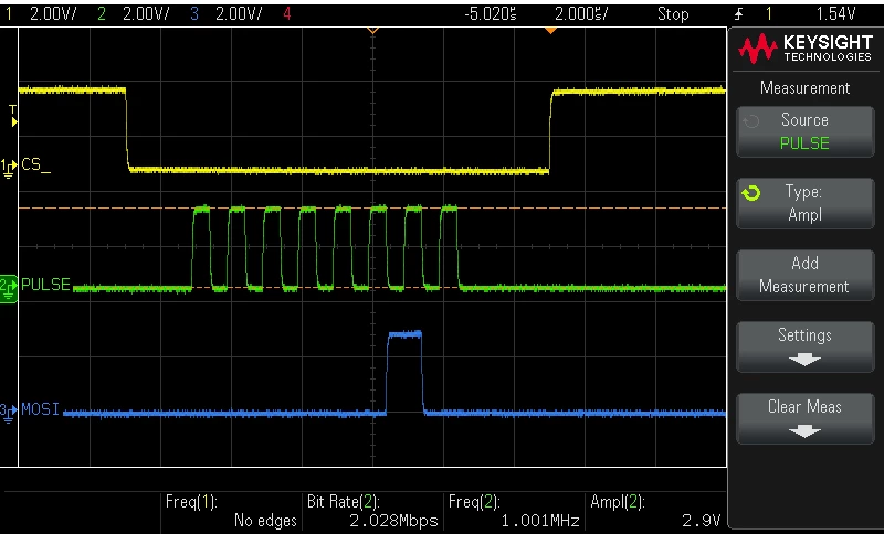

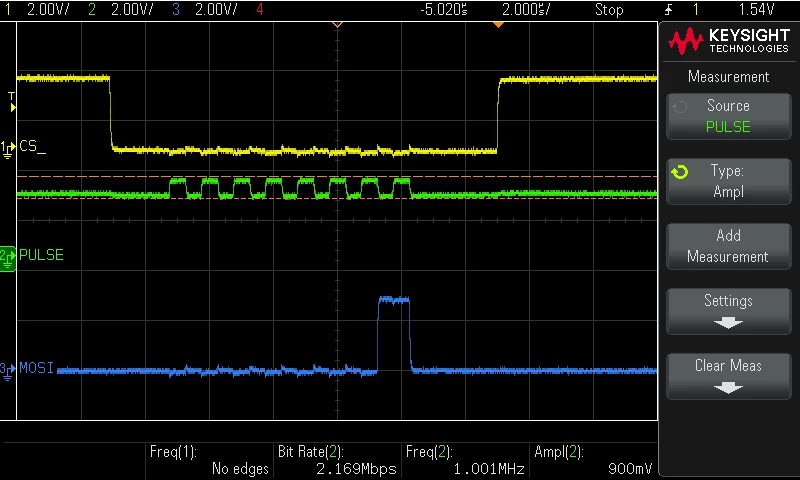

EDIT : Here are the waveforms on scope. When disconnected from slave, the waveforms are perfect. However when I connect the master to slave, there is some noise and the SCL line has a amplitude of 900mV.

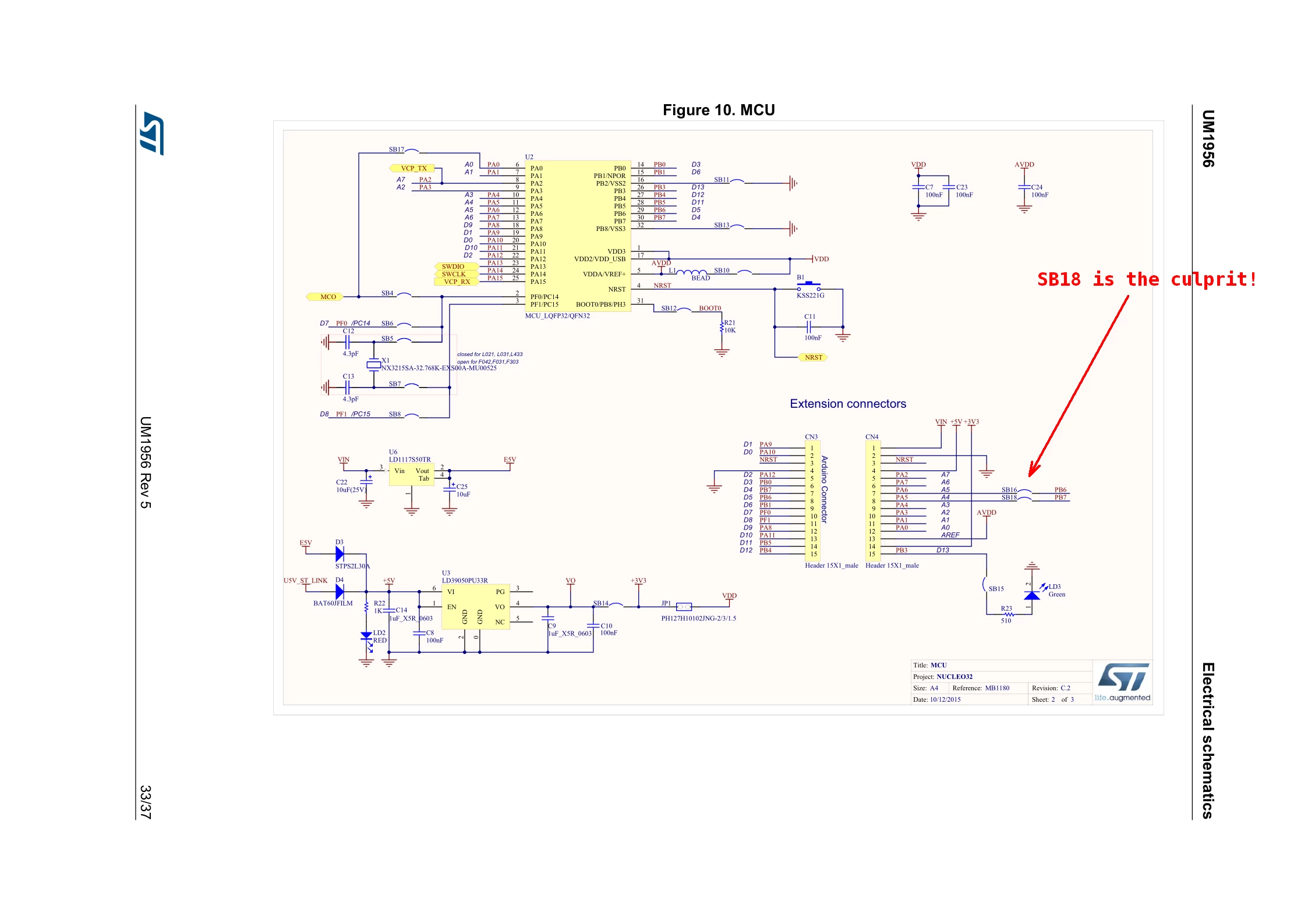

> I've added the waveforms from scope please check that out. When connected this slave device, the SCL line goes a crazy.
That's SCK fighting against a pin being set high. Check your connections, maybe SCK from master goes to something different than SCK of slave.
Is the slave something like a Disco or Nucleo? If yes, are all relevant onboard connections (jumpers, solder bridges) disconnected?

I've uploaded some waveforms please check that out. When connected to slave, the SCL line goes crazy.

My master device is a Disco board (STM32F303). I've tried a very similar program with same transmit subroutine on a port expander (MCP23S17) as slave and there it works perfectly fine. So I believe the master side has no issues.
My slave in this program is a Nucleo L432KC. While I have removed the jumper it came with, I'll look into the user manual to see if that particular pin is connected to something else, or I might try different pin or different SPI module (SPI3). I had set this same device (and with same pins) as a master to experiment on port expander I mentioned above couple of weeks back and had no issues.
> I checked user manual to see if PA5 was connected to something and don't really see anything.
Which user manual did you check?
