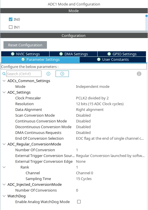

For a couple days now I have been trying to read out the voltage through the onboard ADC configured for 12 bits but all I am getting back are values in a similar range (mostly somewhere in between 1500 and 1800 but that changes with the amount of delay that I introduce, does that help?). The value itself does change, floating within that range.
I have tested for faulty connections and switched the board but the issue persists.
It is a very basic setup, just a potentiometer connected to the A0, and it works if I use an Arduino with its framework to try and read the value (the potentiometer is not broken). But also supplying A0 with ground or 3.3v directly doesn't change the read value. After reading the value I write it to serial, which is also working.
My guess is that something with my clock configuration is wrong and the ADC has not enough time to run a meaningful measurement.
I hope that any of you can help, thank in advance!

I used CubeMx to generate the pretty much all other code, besides a tiny bit in the CDC_Receive_FS function for communication. Here is my ADC configuration:
PCLK2 is configured for 14Mhz

It sounds like the pin you're monitoring isn't changing in value. What board is this and how is that pin hooked up? Look at the schematic to verify connectivity between pin and header. Set PA0 as an output, toggle and monitor to establish that you're monitoring what you think you are monitoring.
Unlikely to be any issues in the ADC setup.

Is the ADC enabled ?
Once it is working, increase the sampling time to >100 cycles for better accuracy

You were correct and apparently I cannot use port 'A'? I've tested different ones and all of them do not respond. Just to make sure that the board isn't broken I tested a pin on port 'B' (specifically PB15 if that matters) and it works as expected. The onboard LED works as well. I connected an LED to the pin and set it to GPIO_Output.
I am using a blackpill with this pinout.Is there maybe something special about the 'A' ports? Do I have to enable them somehow?
