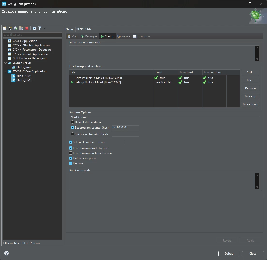

I've seen this issue in a few places. Some with solutions, none of which have worked for me. I am programming a Portenta H7 via a Portenta Breakout board with an ST Link v2 (please don't direct me to the Arduino forum. I have this conversation going over there as well).
CM4 DEBUGGER FAILS TO RUN
OR ST LINK IS FAILING TO CONNECT

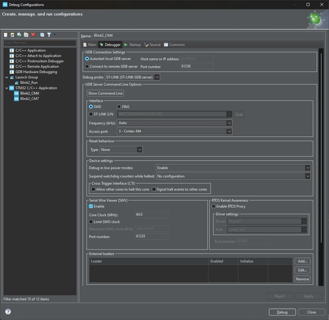

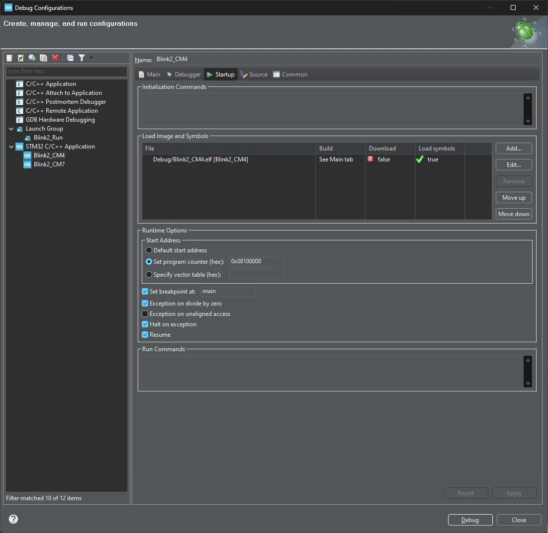

In both projects, I start the CM7 debugger with no problems. When I start the CM4 debugger in either project, I get this error:
COM frequency = 4000 kHz
Target connection mode: Attach
Failed to read ROM table via AP 3
Error in initializing ST-LINK device.
Reason: Unknown. Please check power and cabling to target.
With this dialog popup:
Error in final launch sequence:
Failed to start GDB server
Reason: (255) Unknown. Please check power and cabling to target.

ST Link connections are fine as I can download the Bootloader, CM7 and CM4 .elf files from STMCubeProgrammer.
  • The Bootloader (portentah7_bootloader_mbed_hs_v2.bin)
  • CM7 address 0x08040000
  • CM4 address 0x08100000
  • My linker file for both CM7 and CM4 FLASH entry are set accordingly
  • Debugger configurations for both CM7 and CM4 Startup->Set program counter (hex): are set accordingly

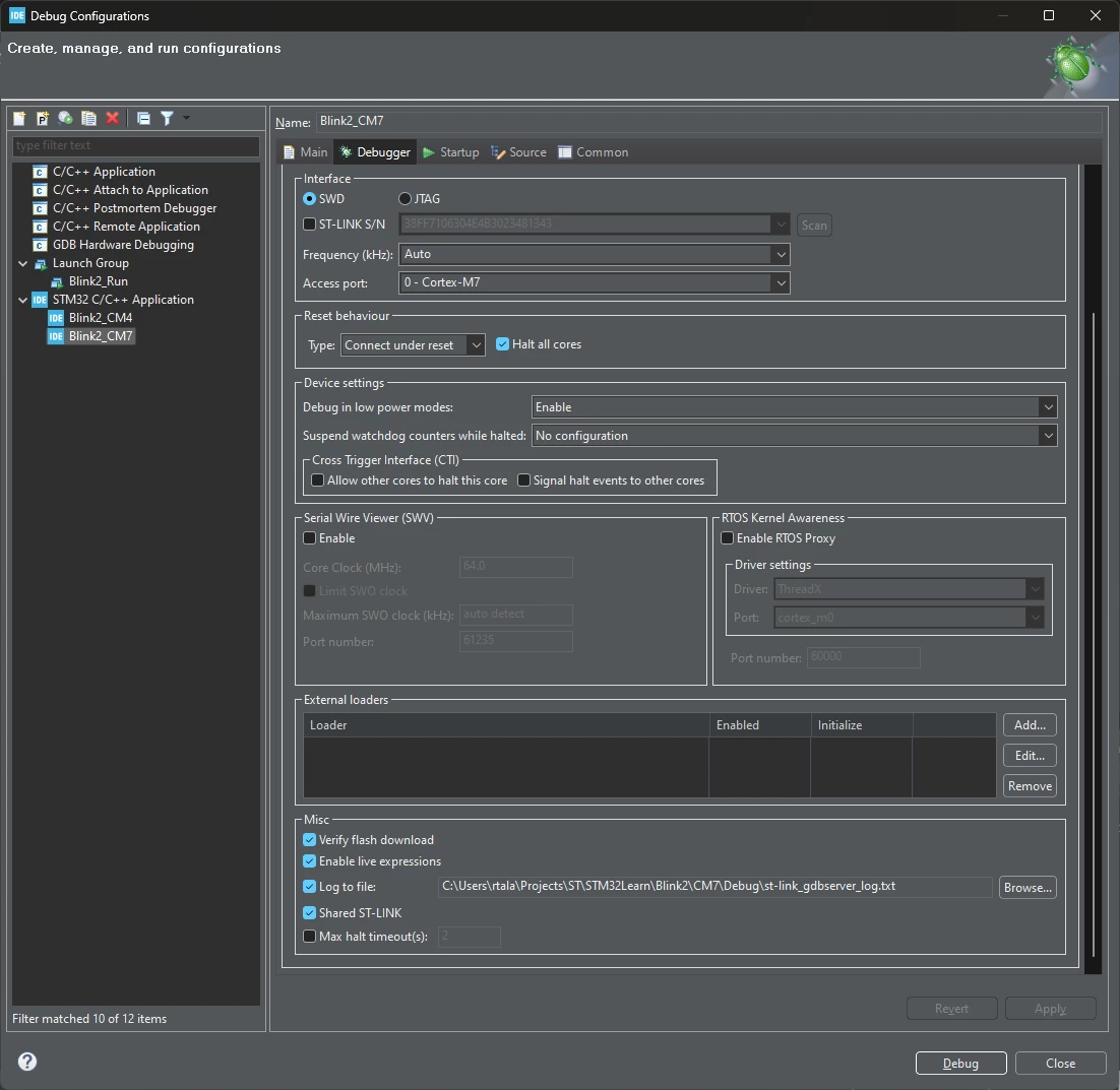

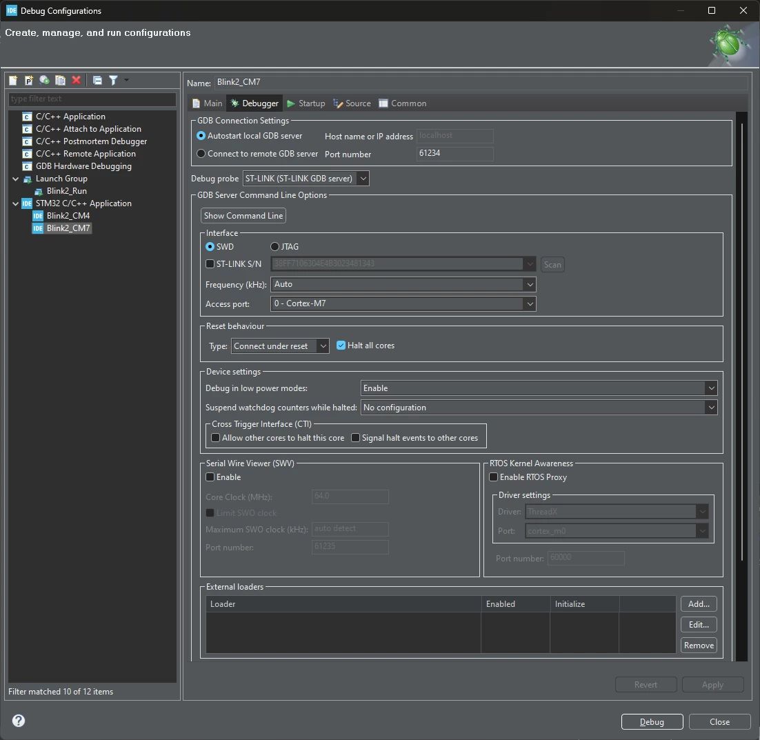

This post on GitHub follows the same debugger setup as AN5361 Section 3 with one exception: in the CM7 configuration, it shows 'Halt all cores' as checked which contradicts AN5361 . Which one is correct or does it matter?
I also implemented this suggestion from that post:
while(__HAL_RCC_GET_FLAG(RCC_FLAG_D2CKRDY) != RESET) { asm("NOP"); }
Of course, all help/suggestions are greatly appreciated!

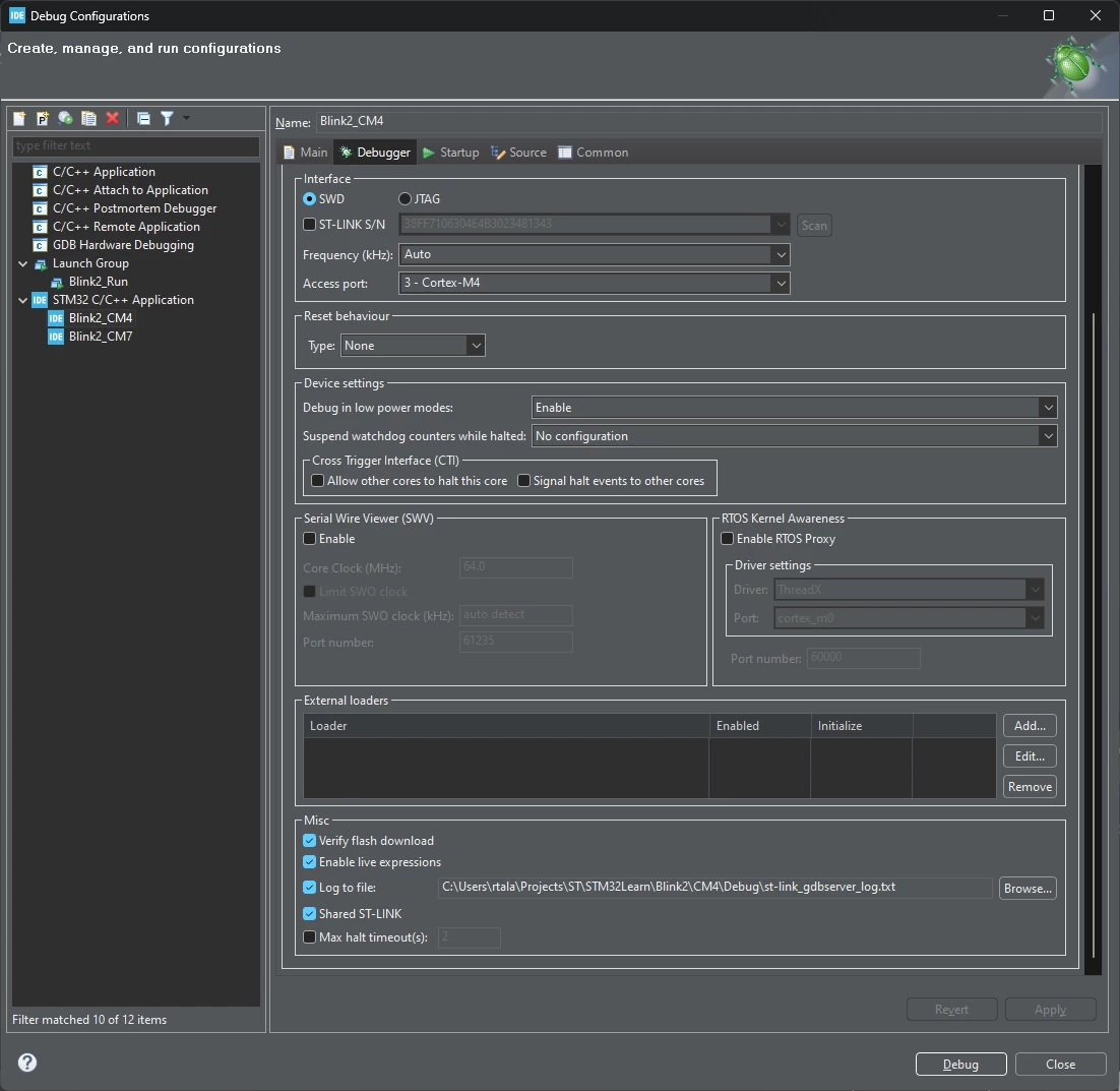

Here are my debugger settings for both cores:
CM7
CM4

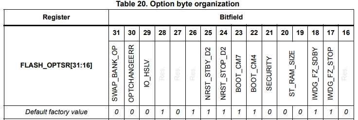

Hello @rtalan
When CM7 is stuck and is waiting for RCC_FLAG_D2CKRDY, it means the D2 domain has not booted properly.
As CM4 is in D2 domain, did you checked the option byte BOOT_CM4 is correctly enabled on the device?
Can you also confirm that NRST_STOP_D2 and NRST_STBY_D2 option byte are enabled?
Here a link for a similar issue if these option byte are not properly enabled.
Dual Core boot up example · Issue #34 · STMicroelectronics/STM32CubeH7 · GitHub

Well the BCM4 flag OB was the culprit. I am finally running both cores!
I have read through the STM32CubeIDE and STM32CubeProgramming manuals and I've never seen anything that explains the Option Bytes. The STM32CubeProgrammer Section 2.4 simply reads "For more details refer to the option bytes section in the programming and reference manuals, available from www.st.com
Which manuals is it referring to?
Does STM have a central location for all of the documentation? I have also perused all of the docs shown on the CubeIDE Information Center and I never saw anything about Option Bytes. Where is the document that explains Option Bytes?
Again, thank you for your help!

The Reference manual in question is RM0399, which you can find here.
https://www.st.com/resource/en/reference_manual/rm0399-stm32h745755-and-stm32h747757-advanced-armbased-32bit-mcus-stmicroelectronics.pdf
Their description is in section 4.4 FLASH option bytes.
As the STM32H747 is dual-core, both the Cortex-M7 and M4 cores are enabled for all devices leaving our factories. This is the default configuration (see RM0399 in Table 20. Option byte organisation) and you would find this on one of our NUCLEO-H745ZI-Q or STM32H747I-Discovery boards:
https://www.st.com/en/evaluation-tools/nucleo-h745zi-q.html
https://www.st.com/en/evaluation-tools/stm32h747i-disco.html
I think that disabling the BOOT_CM4 byte option is done by Arduino? Do their SDK and example use both cores? I don't know?
