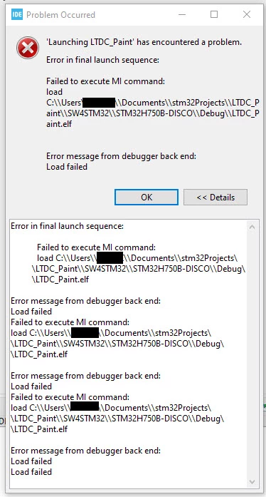

I bought the STM32H750B Discovery and wanted to program a first example "LTDC Paint" on the demo to start.
I am using the STM32Cube IDE version 1.9 (default installation, no changes made).
Procedure:
- File -> New -> STM32 Project -> Examples -> select the Discovery Board -> select the LTDC Paint example -> Run LTDC Paint
Then I get the following error message, see attachment:
"Failed to execute MI command.... Load failed ... LTDC_Paint.elf"
Which configuration did I miss?

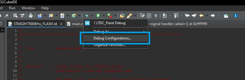

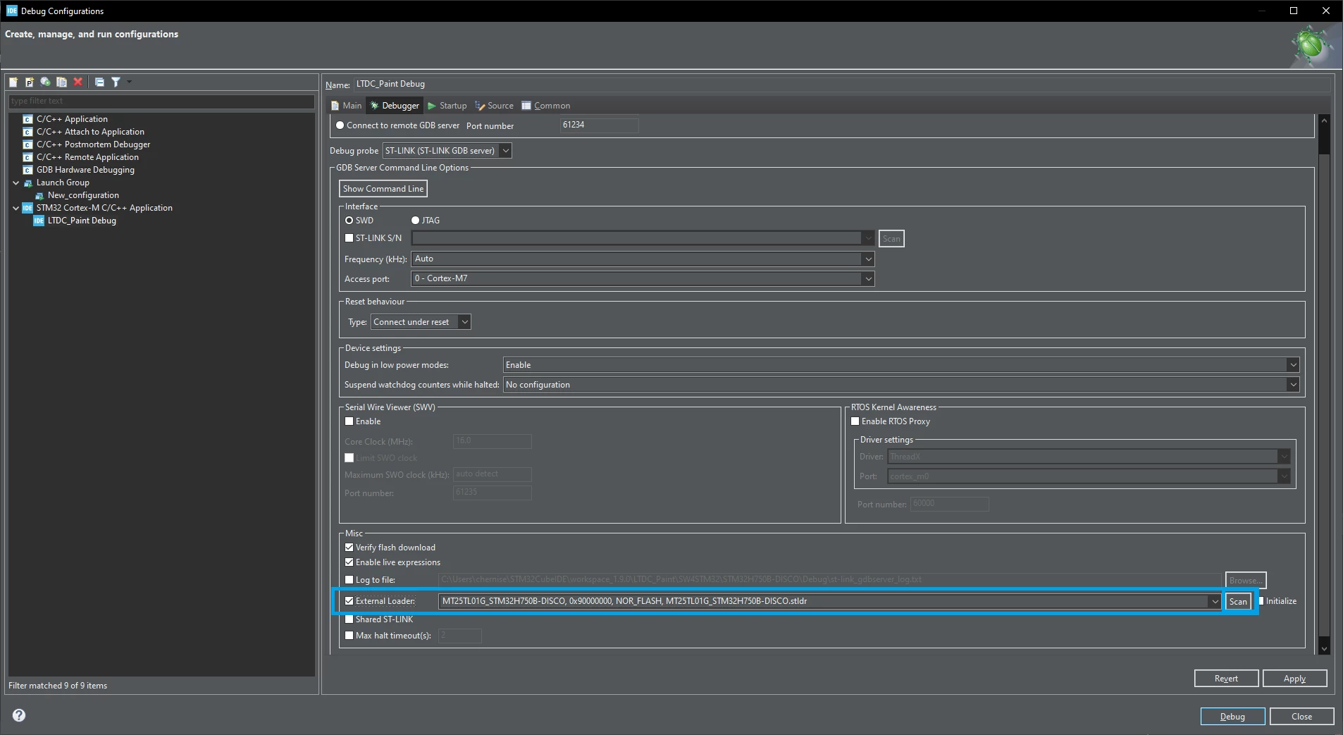

And after further analysis I observed that the used example in this case use an external memory.
In this case you should set the Debug configuration in the CubeIDE to accommodate this.
  • Go to the Debug Configuration
  • Click on "SCAN" button and select the adequate external loader for the "MT25TL01G_STM32H750B-DISCO, 0x90000000, NOR_FLASH, MT25TL01G_STM32H750B-DISCO.stldr"
Feel free to repost about the efficacity of this solution.
Your feedback will be very helpful.
Kind regards,
Semer.

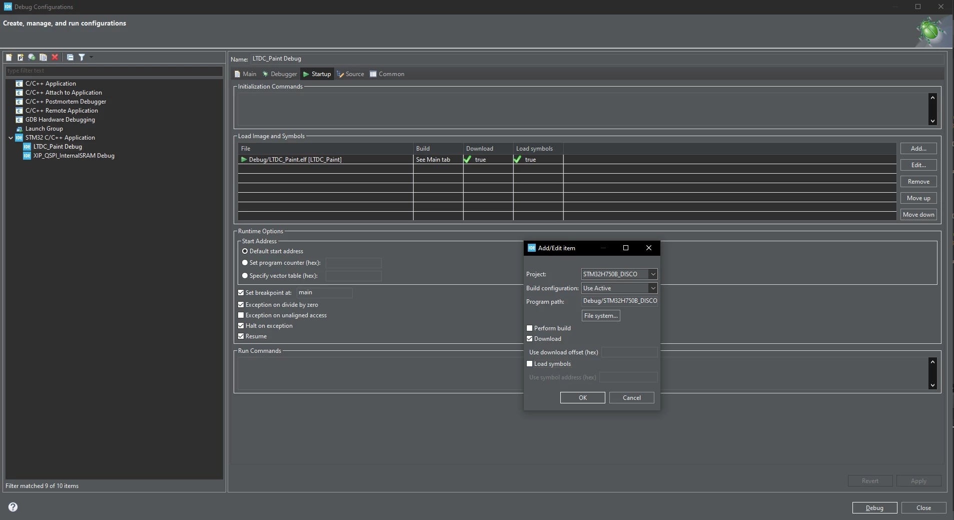

pk84
pk84Author
Sep 13, 2022 1:23 PM UTC
Thanks, I will try this solution as soon as possible.
Still one question:
1) What if I want change the pin-configuration of the connected QSPI-Flash (in case of a customized board) ? Where can I do this? I ask because there is no QSPI driver file in the LTDC example.
Semer CHERNI
Sep 15, 2022 2:24 PM UTC
Hello @pk84​
My bad I forgot to mention this part in my reply.
In fact since the example project is stored and executed from external memory you need to flash the "ExtMem_Boot".
The boot project take care of the init of the QSPI interface.
The boot project could be found under "STM32Cube_FW_H7_V1.10.0\Projects\STM32H750B-DK\Templates".
Import the "ExtMem_Boot" to CubeIDE and build it.
Go to the debug configuration for the LTDC Paint example project and under [Startup] add the download of the ExtMem_Boot" binary. (check screenshot bellow)

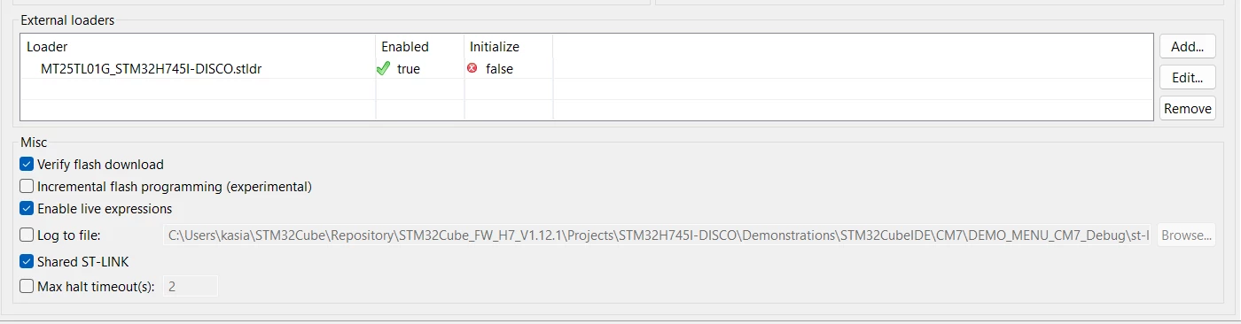

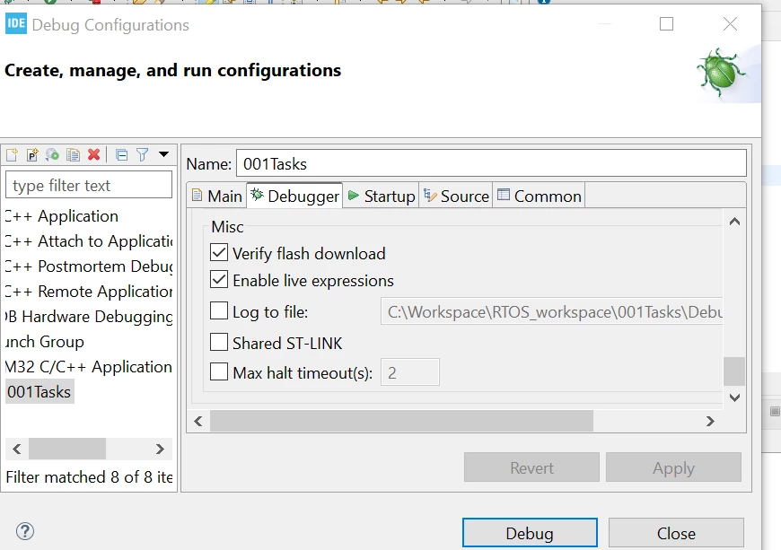

May 28, 2024 10:22 AM UTC
I am facing same issue but In my application external loader option is not showing , how to resolve this issue .Capture.PNG

Zaher
Senior II
Oct 7, 2025 8:05 AM UTC
@Semer CHERNI
Thank you for the solution. It worked flawlessly for me on the STM32H747-DISCO as well!
