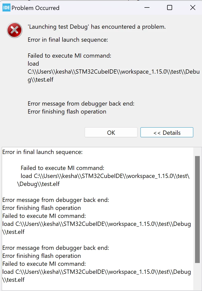

"Failed to execute MI command ...error from the debuggers end"
  • September 5, 2024
  • 1 reply
  • 2385 views
i'm using Stm-Cube ide version 1.15.0 and getting this error when trying to flash the firmware.
1 reply
September 5, 2024
Can you connect using the standalone STM32CubeProgrammer program?
What does test.elf do? If it goes into low power modes, or re-initialized SWD pins, or erases FLASH, this will cause issues with debug.
Is this a known good ST board or custom hardware?
September 6, 2024
it is a nucleo board-L452RET6
September 6, 2024
And the answers to the other questions?
