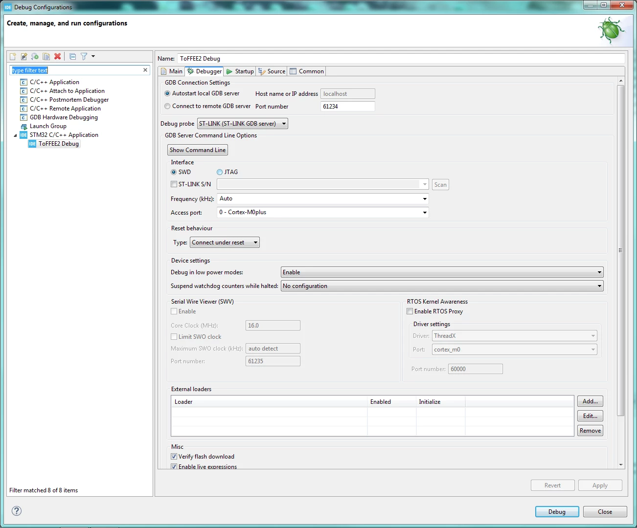

Usually caused by debug or run configurations remaining from the older IDE version.
Try to create a new debug config from scratch.
#bugreport CubeIDE team, can you consider to fix tools paths in old configs automatically?

Pavel A.
February 25, 2025
@pretoriandave So you have created a 100% new debug config "ToFFEE2 Debug" and get the same error?
Though ...
The new C0 project which was built using 1.17.0 in the first place exhibits the same problem.
This should create a new configuration for sure, so it hints to a different problem...

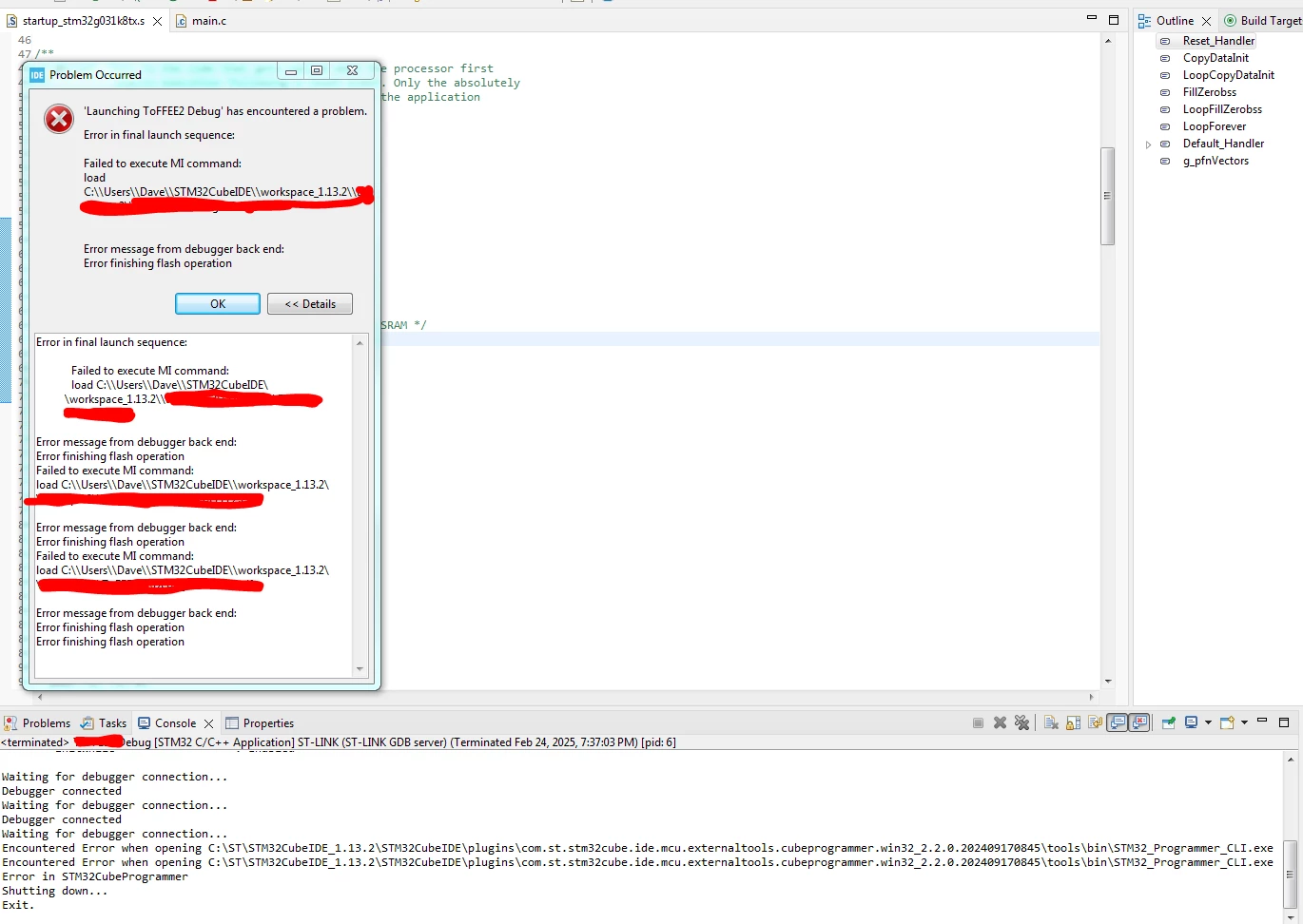

February 25, 2025
@Pavel A. yes I came to the same conclusion. Not on Win 11 unfortunately.
Is this anything to go by?....
It keeps popping up so I think it may be.
