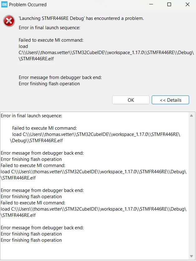

I'm currently trying to familiarize myself with the Nucleo-FR446RE, building the project seems to go on pretty nicely, but whenever I try to debug the code in order to flash it on the FR446, I get the following error :
Problem during debugging (1)Problem during debugging (1)

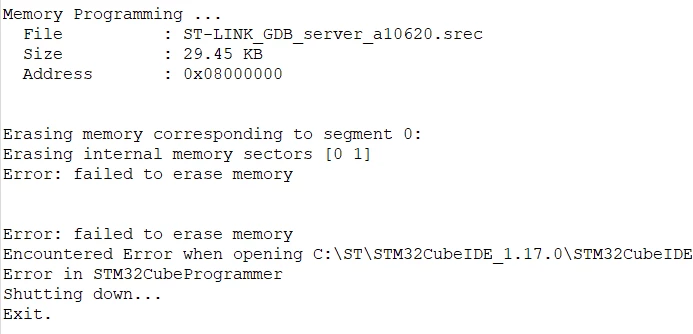

More specifically I get the following error related to the failure to erase the memory :
Debugging error (2)Debugging error (2)

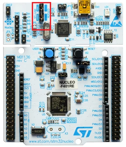

  • I have replaced the cable numerous times, and verified the correct placement of jumpers on the board

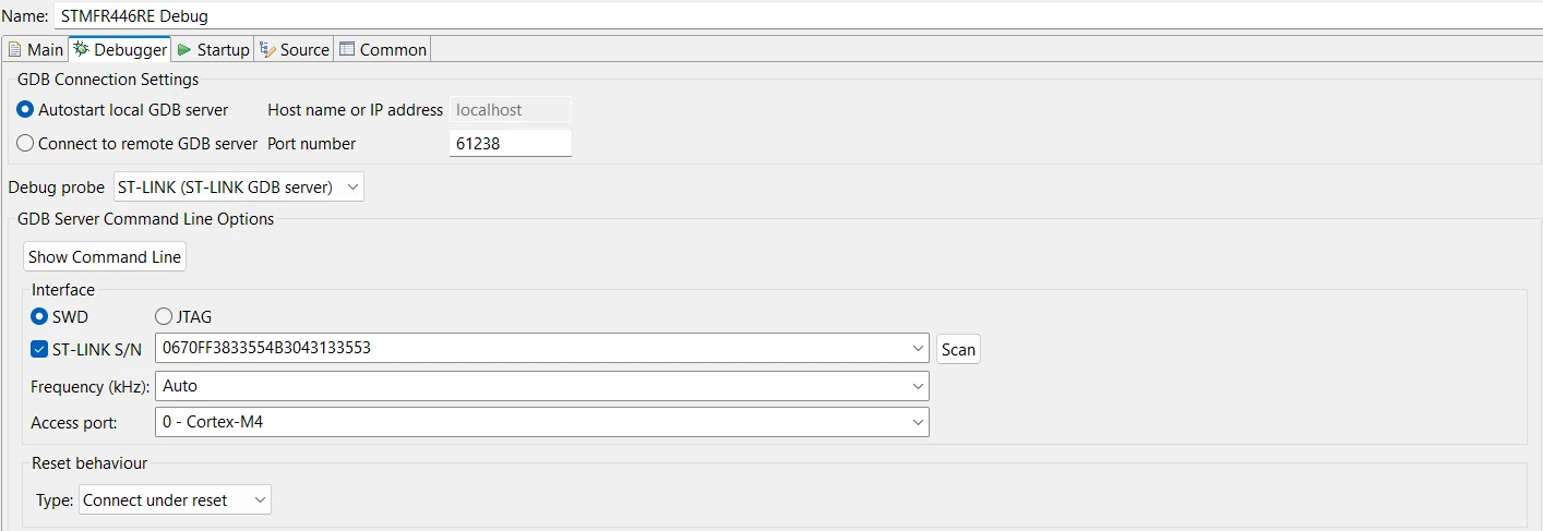

On a sidenote, the debugging settings are as follows :
Debugging settingsDebugging settings

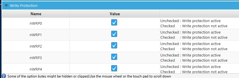

Its seems the write protection is enabled in the option bytes.
This is what I have as configuration:
Unchecked: the sector is write protected.
I'm attaching the option bytes that you can upload to your board in attachment.
You can read this article on how to upload it.

I did try to erase the entire chip's flash memory, as well as manually erasing individual sectors to find the culprit (if that is of any use), and in both cases I had the same error.
More specifically, here would be the error message :
Error messageError message

When you connected with STM32CubeProgrammer, what is the target voltage shown:
What about the availability of these jumpers?
How did you power the board? over STLINK? or VIN pin?
Did you modify options bytes?
Did you modify something on the board?

I had the same message by activating the write protection:
Please ensure you apply the changes you set in the option bytes by clicking "Apply" button. Then you can disconnect and reconnect again and recheck the write protection option bytes.
So, please follow the steps described in the article I shared above o, how to restore the option bytes.

The change of Option Bytes seemed to have worked on STM32CubeIDE but not on STM32Programmer, as I am now able to debug my project, and the flash memory is correctly erased.
I thank you for your time, I will mark the Option Bytes change as the main solution.
