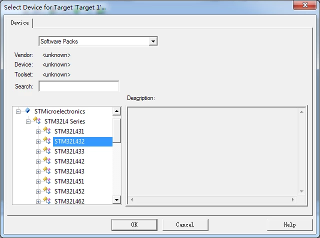

I am using NUCLEO-L412KB dev board. It is said online that Keil can be used as the IDE for this board. However, when I download KEIL5 and also download the package for stmL4 series, I failed to find a suitable target for my board when I tried to create a new project. What should I do to support my board? What else IDE can I use?0690X000006CCwJQAW.png

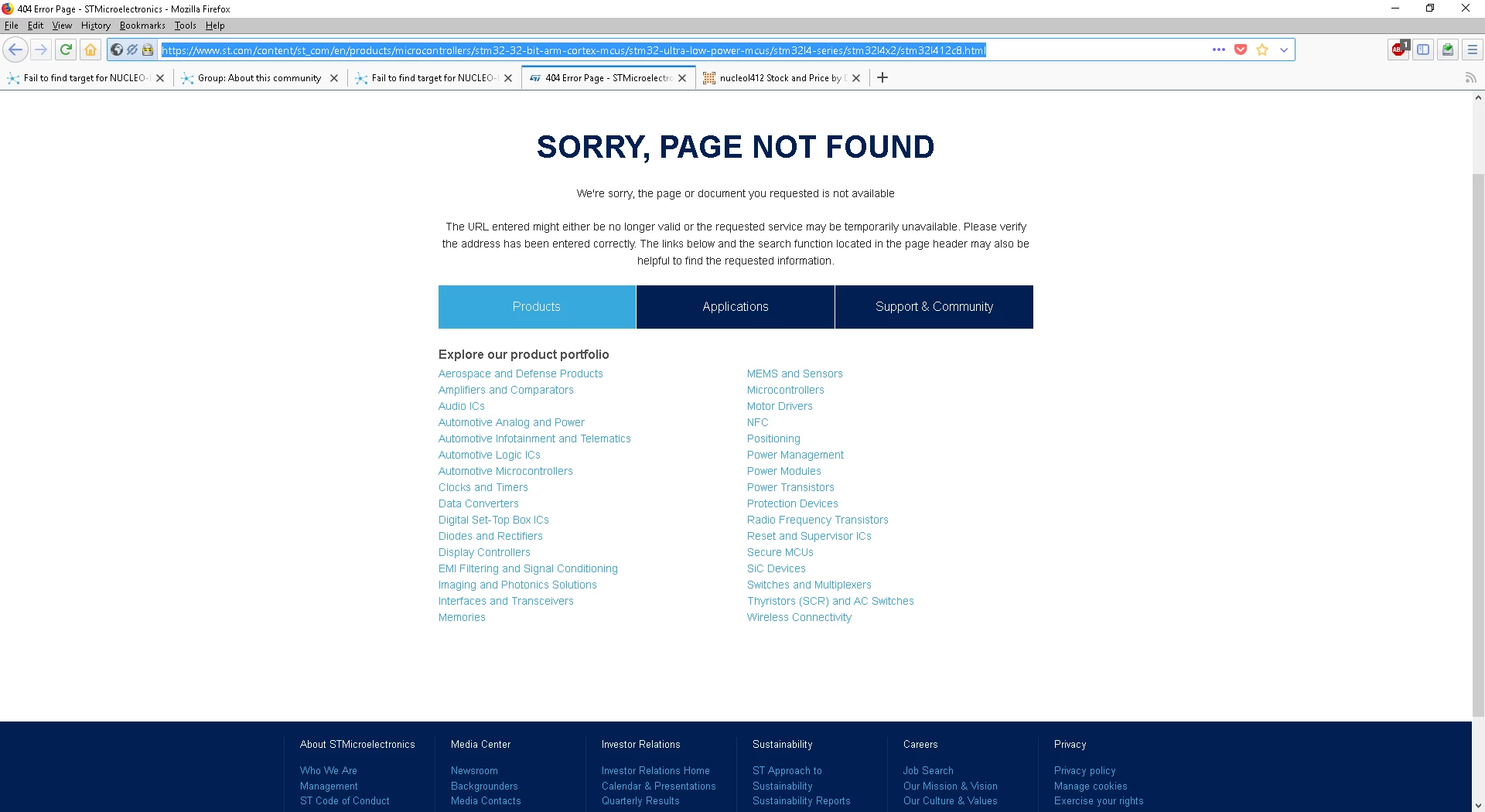

    Maybe because there are so new that the parts don't have their webpage set up yet?

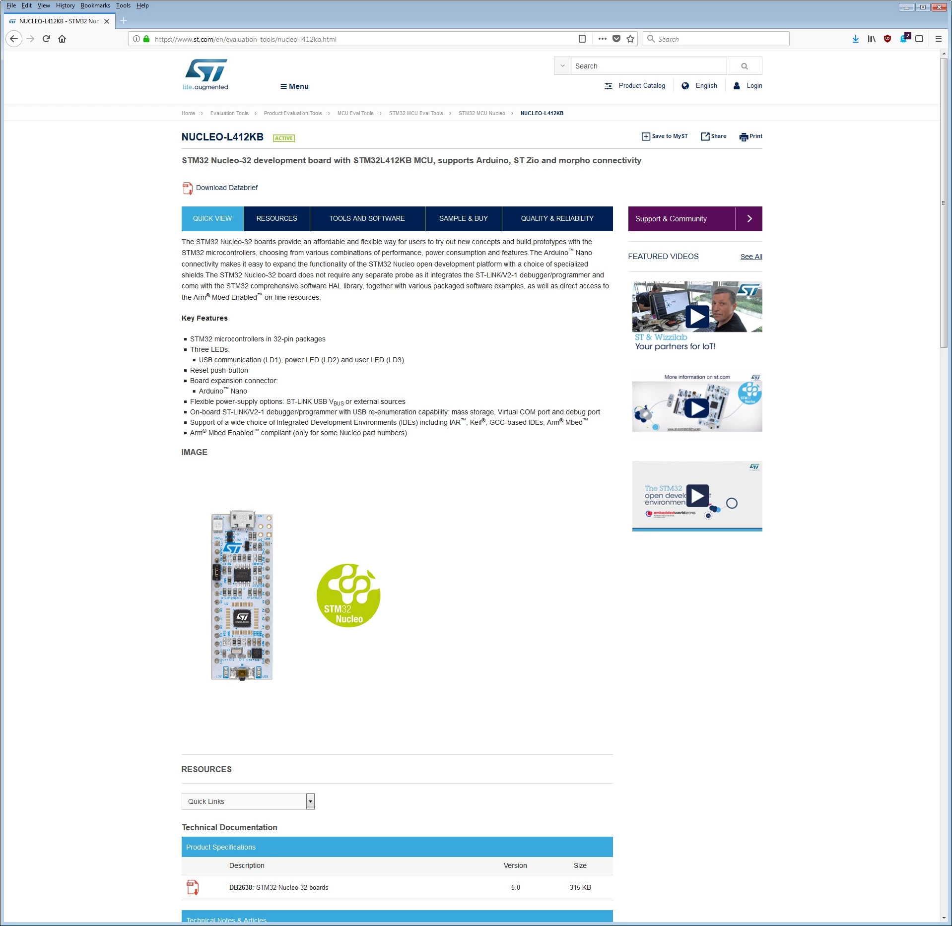

    https://www.st.com/en/evaluation-tools/nucleo-l412kb.html

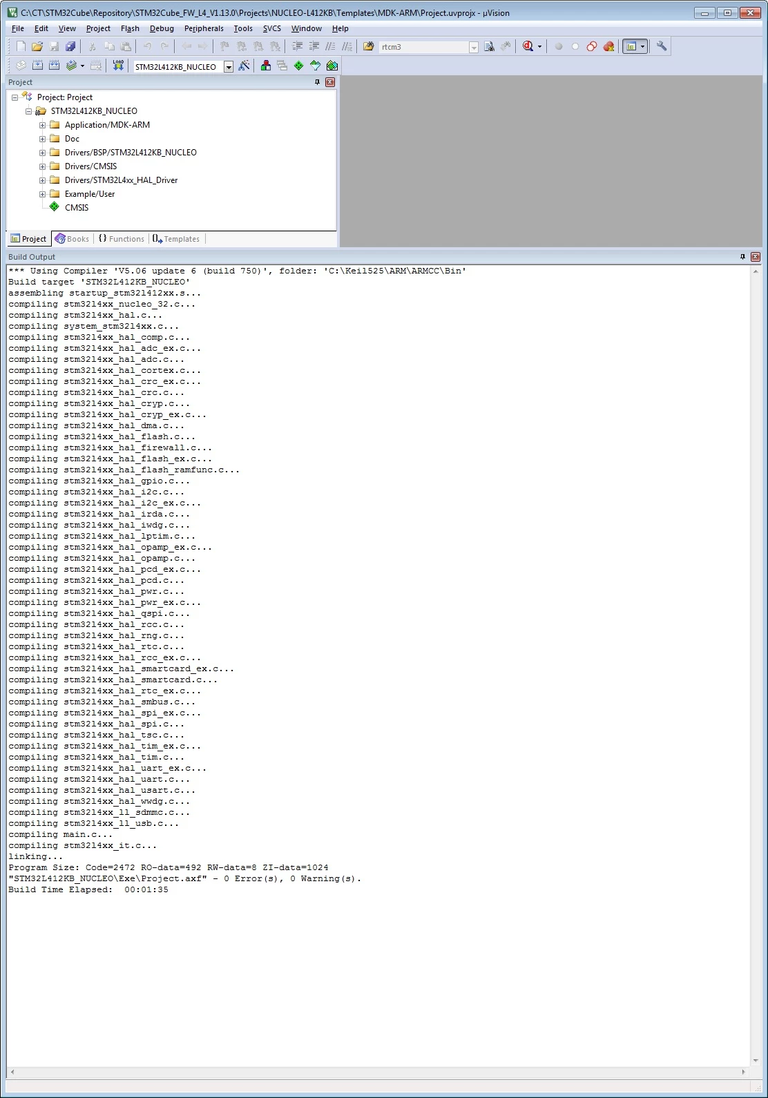

    Going to need to wait for Keil to release a new pack. No packs in the L4 V1.13.0 software directories. Pretty sure you could take a template project and build it, despite complaints from the tools. And create a .HEX you could push via the ST-LINK tools.
