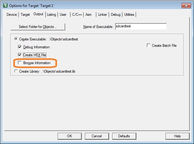

Hi, i'm facing the difficulty of compiling the HAL driver codes takes nearly a 1:30 -3:00 min. So what should i do now?:sad_but_relieved_face:. it is quite a long compilation time for my application.

    What hardware and OS, what toolchain ?
    Sources located on network ?

    In Keil uncheck options to generate Browse Information

    stm32f429 mcu , arm keil tool chain @Community member​

    i don't get it what you said??

    No, I meant the PC hardware. Or do you run the compiler on the target ... ;)
    If Windows, what does the task manager say while you build ?

    Perhaps a picture?

    Keil has some egregious issues with the browse information (at least in the 5.x compilers) where a rebuild of a HAL example might take several minutes, and perhaps 10x or 20x slower than necessary.

    @Community member​ it's works very well. it means a lot for me. thanks a lot.
