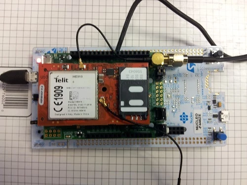

    The picture for the F446 model is a bit deceptive, it doesn't actually have Ethernet support.
    Currently I have some F446, F429 and F746 Nucleo-144's to play with.
    Here I wired up a GSM Modem Shield, hooking up a 7V DC supply to VIN to power both the modem and Nucleo.
    http://www.janus-rc.com/JanusArduinoShield.html
