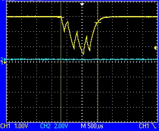

I see a very gruesome trace out of PA9:
I get the same track with either the MAX3232 chip connected or not. The PC interprets it a E9 (233).

Posted on March 26, 2012 at 16:58
Dunno, is USART1 viable on the STM32F4 Discovery on these pins? Check the schematic.
Always assume the hardware isn't going to magically configure itself. Review some of the peripheral examples to get a feeling for how it's done, the API documentation mostly describes the functions, the reference manuals are the best place to understand the hardware. I've been using USART3, I had to mod this example to get you USART1. Here's a build using PB6,7 as the USART1 pins

It works with the alternate pins (PB6 as TX). PA9 is connected to an LED which is why it is capacitively slowed and creates a nasty trace (might work at 1200baud :-).
Thank you for your help!

you can see on STMF4 Discovery user manual (page 34): on the PA9 there is a 4.7uF capacitor. If you want to use UART1 TX then you must remove this component and you must care about PC0, you must keep it HIGH.
I suggest use UART6, the pins for UART6 is near to UART1 on the header. (PC6 Tx, PC7 Rx).
