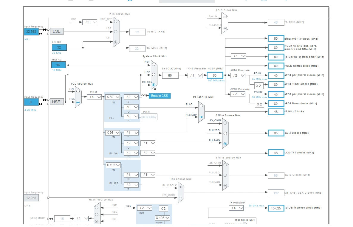

we want to use the STM32F469i as a Dashboard in our Formula Student car but we are having trouble receiving any can data whilst transmitting works just fine. We tried allot allready but nothing has worked for us so far.
We are using a PCAN-USB adapter and a TLV7251V CAN-Transeiver for our test setup. We tried to follow the can example for the F469eval board as close as possible (as there is no can example for the f469i-disco) but in normal mode not loopbackmode.
We tried receiving via polling and interrupt without success and we aim to make it work with interrupts.We activated the interrupts for RX0 and RX1 (we also tried using only one of them). We setup the Callback but it doesnt seem to trigger.

Here are our system clock settings (we heard they are important for the interrupts to work properly so we only changed as little as possible):

Here is a picture of our clock setup graph:
We attached the full project (only changes in main.c where made) in case that helps.
We are very thankfull for every tip that you might have.

You have an issue with the filter configuration:
You're using CAN2 and FilterBank = 0 with SlaveStartFilterBank = 14! This can work with CAN1 but not with CAN2:
 /* USER CODE BEGIN CAN2_Init 2 */
 	sFilterConfig.FilterBank = 0;
 sFilterConfig.FilterMode = CAN_FILTERMODE_IDMASK;
 sFilterConfig.FilterScale = CAN_FILTERSCALE_32BIT;
 sFilterConfig.FilterIdHigh = 0x446<<5;
 sFilterConfig.FilterIdLow = 0x0000;
 sFilterConfig.FilterMaskIdHigh = 0x446<<5;
 sFilterConfig.FilterMaskIdLow = 0x0000;
 sFilterConfig.FilterFIFOAssignment = CAN_RX_FIFO0;
 sFilterConfig.FilterActivation = ENABLE;
 sFilterConfig.SlaveStartFilterBank = 14;
You need to set SlaveStartFilterBank = 0.

May 11, 2024
Thank you so much, it works now!!!
