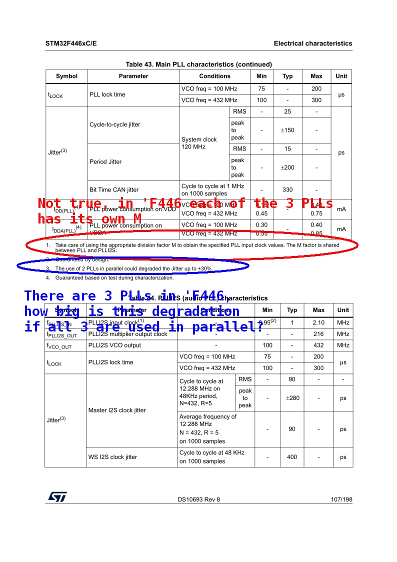

'F446 DS - PLL description discrepancies
  • September 3, 2020
  • 3 replies
  • 1082 views
Obviously copy/paste, probably from 'F40x, ignoring the differences.
ST, please fix.

Hello @Community member​ ,
I will raise this to the appropriate team for correction.

Hello @waclawek.jan ,
These issues are fixed in DS10693 Rev 10.
Thank you for your contribution.
