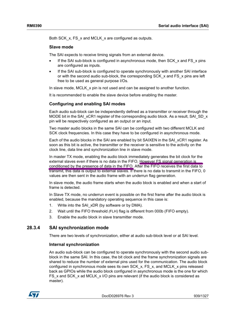

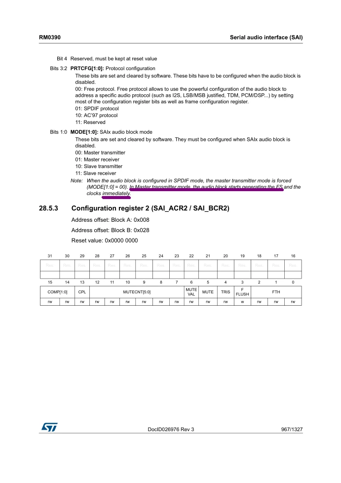

['F446 documentation] SAI - FS generation in master Tx mode
Posted on January 16, 2018 at 12:26
These clearly contradict. So, which one of them is true?
