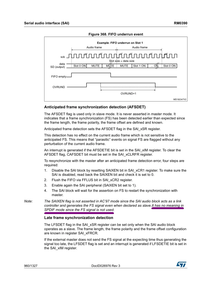

In the context of previous sentence, this sounds like SAIXEN would have no meaning in SPDIF mode.
I'd reformulate the latter sentence as ''AFSDET has no meaning in SPDIF mode...''
