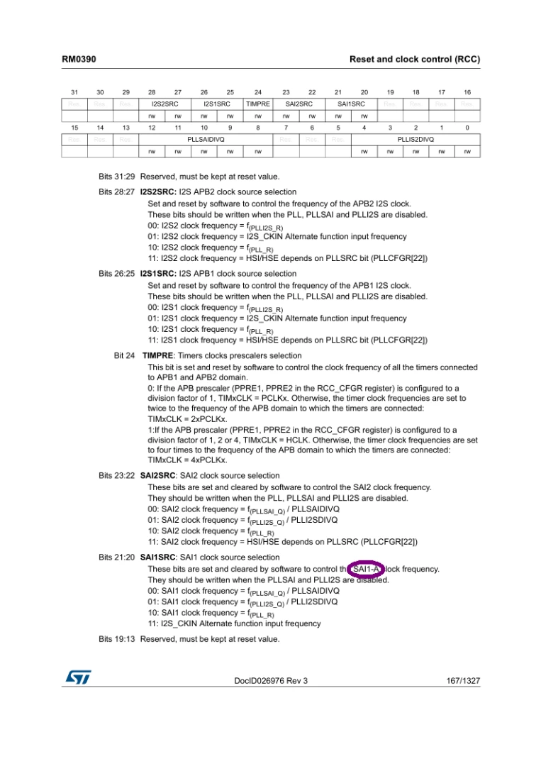

['F446 documentation] RCC_DCKCFGR.SAI1SRC - is it only for SAI1-A?
  • January 2, 2018
  • 1 reply
  • 518 views
Posted on January 02, 2018 at 22:54
Is this a typo, or are there some other register bits which allow to select the source of the SAI1-B clock frequency?
    1 reply
    January 3, 2018
    Posted on January 03, 2018 at 15:26
    Hello
    Waclawek.Jan
    I confirm this typo, it should be SAI1.
    I raised this typo internally to correct it in the next release of reference manual.
    Thank you for highlighting the issue and sorry for any inconvenience it may bring.
