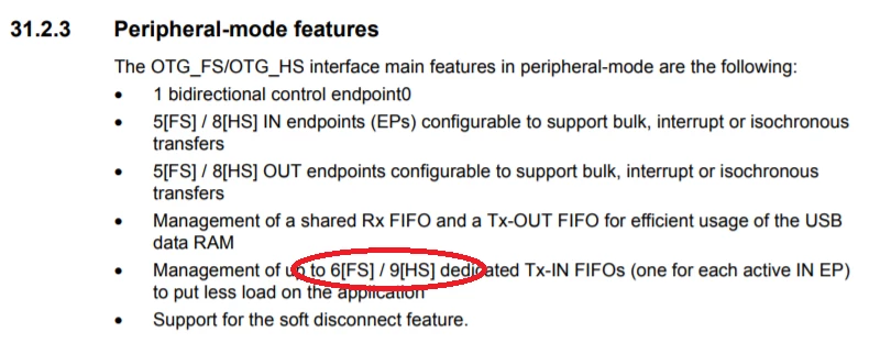

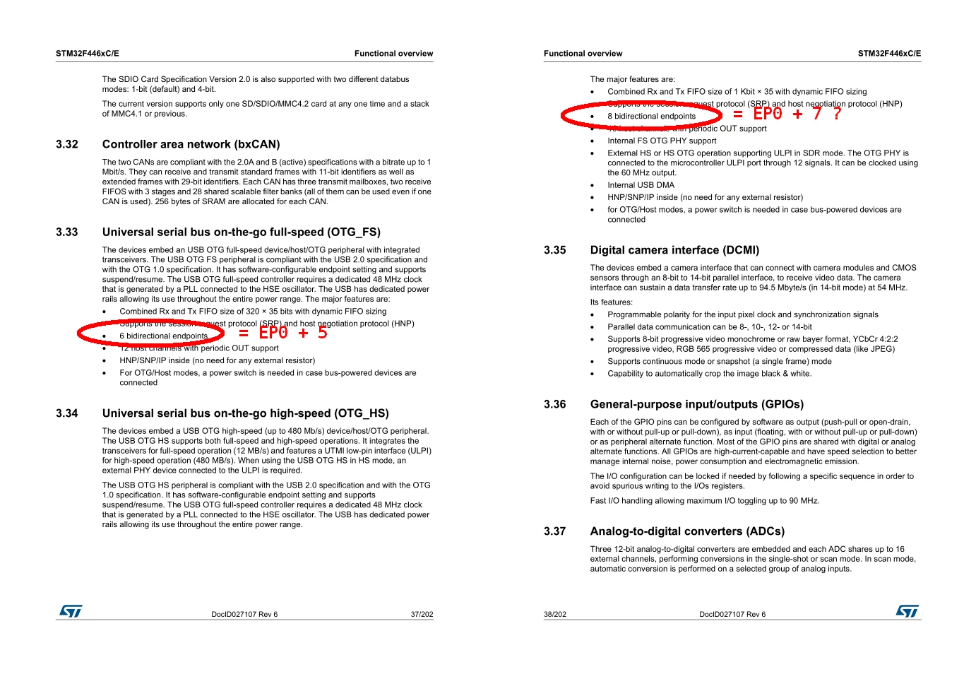

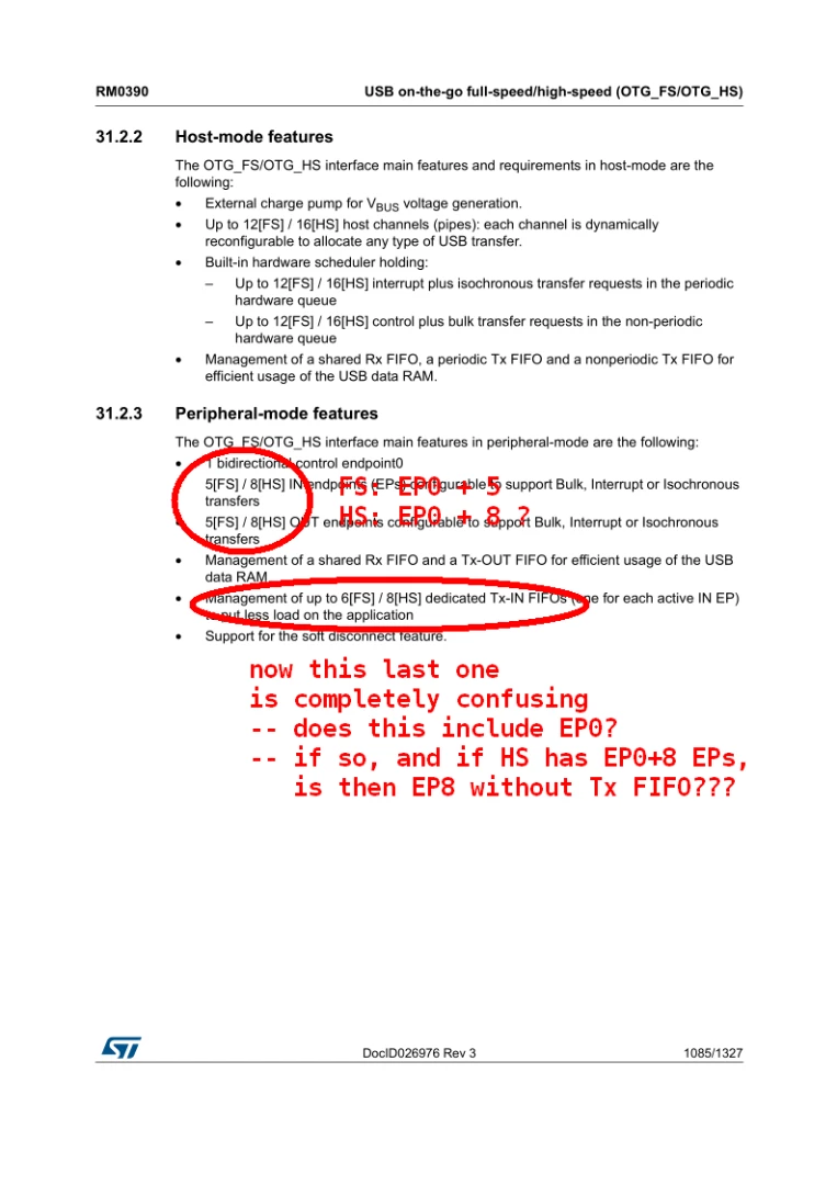

['F446 documentation] How many endpoints has OTG_HS?

    Hello Jan,
    Number of endpoints: 6[FS] / 9[HS]
    -> 5[FS] / 8[HS] device endpoints + 1 bidirectional control endpoint0
    This was fixed on
    http://www.st.com/content/ccc/resource/technical/document/reference_manual/4d/ed/bc/89/b5/70/40/dc/DM00135183.pdf/files/DM00135183.pdf/jcr:content/translations/en.DM00135183.pdf
    Thanks for your feedback.
    Khouloud.

    Hi Khouloud,
    In [STM32Cube_FW_F4_V1.21.0]\Drivers\CMSIS\Device\ST\STM32F4xx\Include\stm32f446xx.h :
    ♯ define USB_OTG_FS_MAX_IN_ENDPOINTS , , , , , , , , , , , , , , , , , , , 5U , , , /* Including EP0 */
    ♯ define USB_OTG_FS_MAX_OUT_ENDPOINTS , , , , , , , , , , , , , , , , , , 5U , , , /* Including EP0 */
    ♯ define USB_OTG_HS_MAX_IN_ENDPOINTS , , , , , , , , , , , , , , , , , , , 8U , , , /* Including EP0 */
    ♯ define USB_OTG_HS_MAX_OUT_ENDPOINTS , , , , , , , , , , , , , , , , , , 8U , , , /* Including EP0 */
    is still wrong.
    I'd say the same applies for HS in 'F469/'F479 (I've seen RM386 being fixed in this regard, I assume the related datasheets are flagged already).
    Jan
    Khouloud GARSI
    March 29, 2018
    Posted on March 29, 2018 at 12:57
    Hi Jan,
    This point is also internally reported and will be fixed soon.
    Khouloud.
