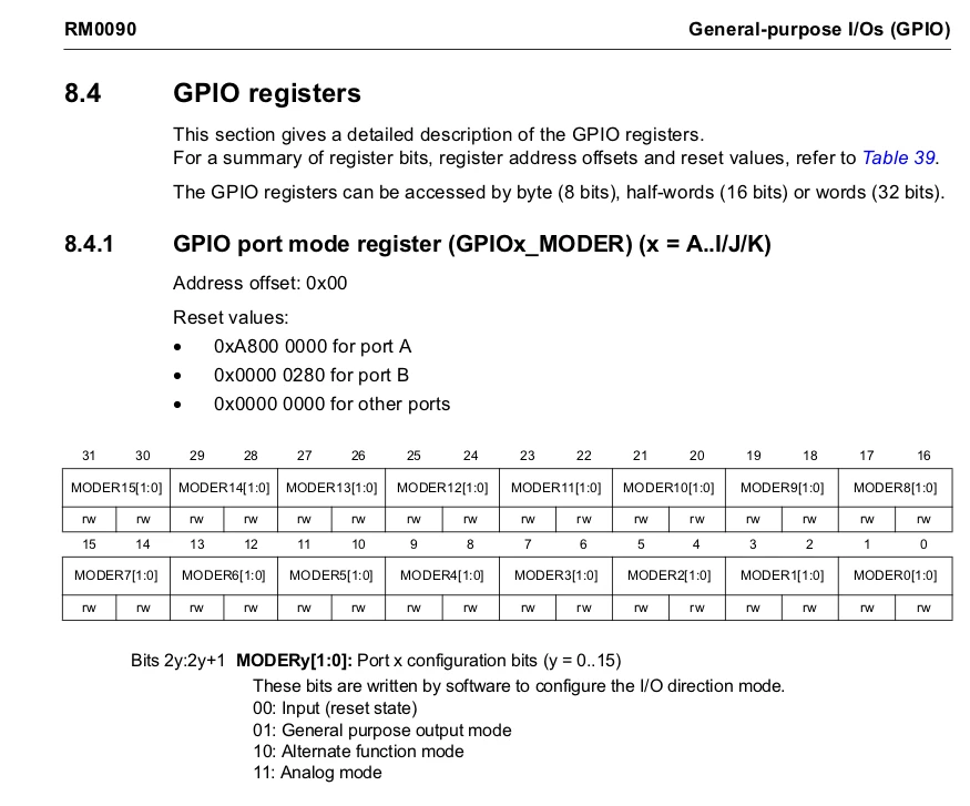

Hello.. i m programming F446 using registers, and i found from F446 reference manual to configure PA1 as both input and pull-down mode. i don't understand , can anyone advise how could
1. MODER &= ~(3<<2)  is to set MODER1 as 00 input?

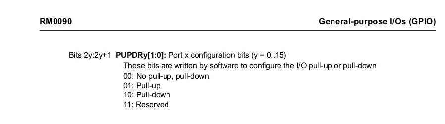

2. PUPDR |=  (1<<3);    is to set  as 10 pull-down mode??  isn't that mean bit 3 set to '1' ??
GPIOA->MODER &= ~(3<<2); // 7.4.1 Bits (3:2) = 0:0 --> PA1 in Input Mode
GPIOA->PUPDR |= (1<<3); // 7.4.4 Bits (3:2) = 1:0 --> PA1 is in Pull Down mode

These bits are quite comprehensively explained in the reference manual :
This example is for a similiar MCU (the F4x5/F4x7).

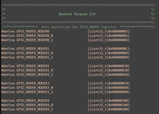

And second, I would highly recommend to use the constants defined in stm32f4xx.h, not magic numbers.
Like here:
If you look at the RefManual description, two adjacent bits define the state of each GPIO.
Bits 0 & 1 for pin 0 (e.g. PA0), bits 2 & 3 for pin 1 (e.g. PA1), and so on ...
And the '~' operator clears those bits, thus they are reset to zero - which mean "input" according to the RefManual.
Thus this instruction sets PA1 to inputs.
The same goes for pull-up/pull-down settings :
Such reference manuals are quite dense, information-wise.
One needs to get used to read them.
Had the author (not you, I guess), used something like this, it would have been more clear:
MODER &= ~GPIO_MODER_MODER1
Even if it's your own code, you forget those details after a few weeks, and you will have a hard time decoding the number magick.
Speaking names and constants have definitely advantages.
