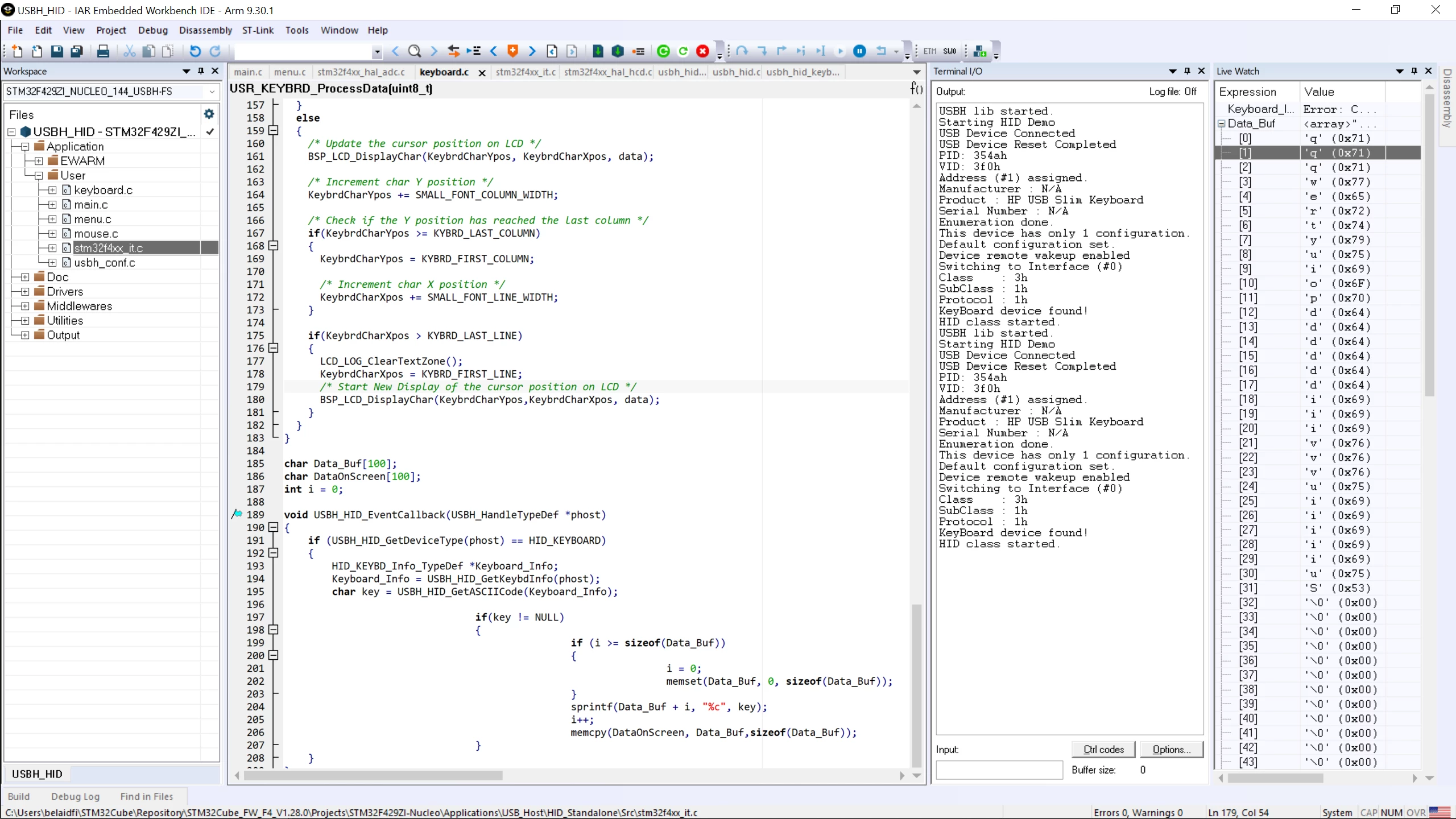

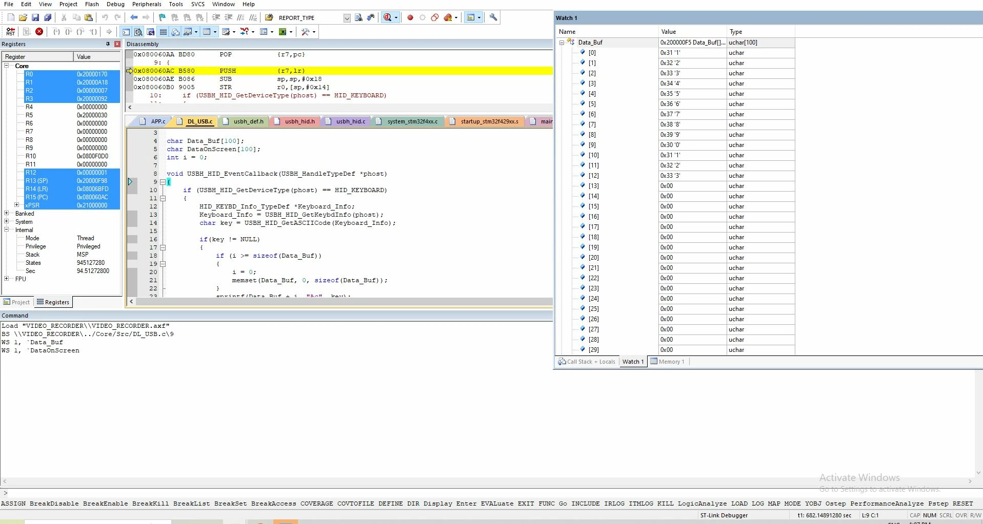

I am facing a problem in implementing USB HID host input for keyboard.
I can get only 12-13 characters in my buffer after which the keyboard doesn't respond to any input as can be seen in snap attached.
source for keyboard handling is also attached

Hello @Manas_Gupta ,
Are you using NUCLEO-F429ZI board?
Could you please take a look at HID_Standalone example, may help you. This is a typical application on how to use the STM32F429ZI USB OTG Host peripheral to interact with an USB HID Device such as a Mouse or a Keyboard.
I hope this help you.

Hi @Manas_Gupta
It seems the maximum packet size that the endpoint is capable of sending or receiving is not sufficient to handle your buffer size. Check your USBH_MAX_EP_PACKET_SIZE and USBH_MAX_DATA_BUFFER

Hi Team,
Apologies for the delayed response. I have been delegated the project from @Manas_Gupta ,I did try the solutions you suggested regarding USBH_MAX_EP_PACKET_SIZE and USBH_MAX_DATA_BUFFER, but unfortunately, they did not resolve the issue. The keyboard still cannot register more than 12 keys at a time.

Hello @FBL ,
Thank you for your ongoing support. I tested this with a new project and it's functioning correctly. There may be other factors affecting my main project that I'll investigate.
