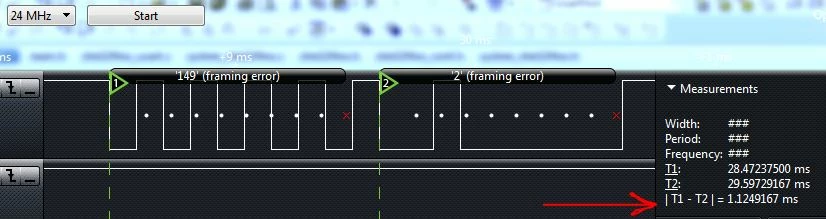

    From the original project i worked on, i used the USART1 when i found the problem.
    the thing is that USART1 only has a small shift in timing, not as large as the USART3.
    So my project has worked 10% of the time, and it took some time before a found the problem.
    So a changed my
    previously
    example to switch to USART1 again, so i can show the problem.
    I initialize the SystemInit(); at startup.
    And the picture shows the USART1 TX output at 9600 baud setting in STM32
    I added a timing reference picture for 9600 Baud, and here we can see that i hole frame should be 1024uS

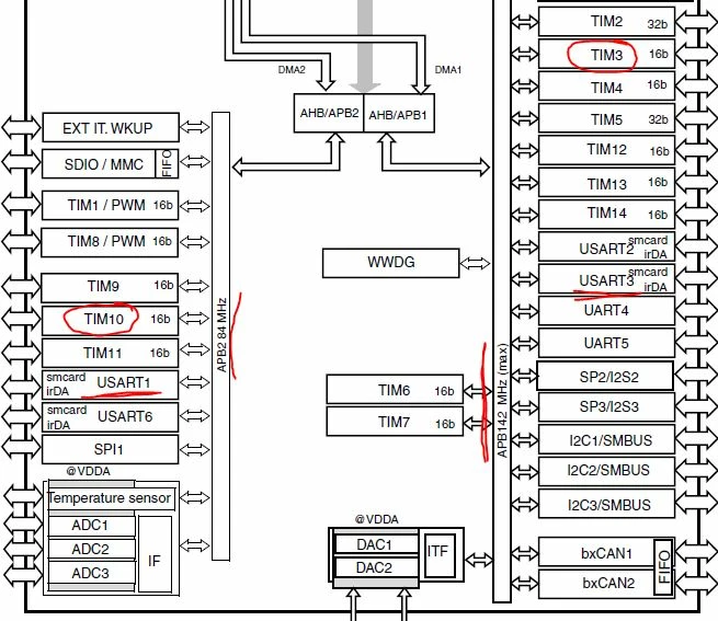

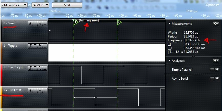

    I know that it has to do with the clock settings, so i put together a example with Timer3(APB1) and Timer10(APB2).
    I made it so both should output PWM on one pin each so i could check so both APB1 and APB2 is running as thy should.
    because USART1 is on the APB2 bus and USART3 is on APB1.
    Both Tim3 and Tim10 is set to 530 KHz
    here we can see that TIM3 CH1 is the selected one, and the Frequency show 5375KHz.
    And TIM10 CH1 is a bit of in phase, but we can see it has the same timing and frequency as TIM3 .
    So the APB1 and APB2 seams to be running at the right frequency.
    but i still get 1124uS frame timing for USART1 and 3255uSframe timing on USART3 when thy are set to 9600baud

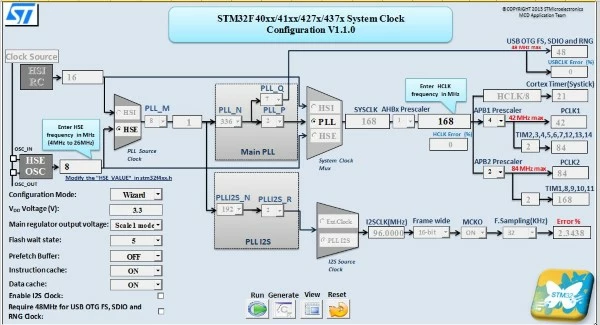

    my settings from the clock configuration that i am using

    You sure the HSE_VALUE has been correctly defined?
    You should also be able to route internal clocks via the MCOx pins if you need to verify them.

    Hi Clive.
    Yes that was my first check.
    I added 2 lines in main.c so i could check the HSI_VALUE
    and added __NO_SYSTEM_INIT in preprocessor definition so i could check HSI_VALUE before the
    SystemInit();
    The debugger says it is 8MHz, but it's strange because the UART timefram time do not change if a change the HSI_VALUE to something else, like 1MHz

    SystemInit();
    I tested to fetch the clock data
    I debugged this code
    int main(void)
    // Only used to check the osc reference values while debug so they are correct
    uint32_t T1 = HSE_VALUE;
    uint32_t T2 = HSI_VALUE;
    uint8_t dummy = 0;
    RCC_ClocksTypeDef RCC_ClocksStatus;
    /* Configure the USART Baud Rate */
    RCC_GetClocksFreq(&RCC_ClocksStatus);
    dummy = 1; <- I put the first breakpoint here
    /* System Clocks Configuration **********************************************/
    SystemInit();
    dummy = 2; <- I put the second breakpoint here
    and i got
    At first breakpoint (all in decimal)
    At second breakpoint (all in decimal)
    Thats weird, you can se that HSI_VALUE (T1) = 8MHz
    but i don't think the clock is running at 525MHz :)
    i tested to change the HSI_VALUE to 1MHz
    result
    you can see that T1 = 1MHz, and the clockstatus has not changed at all
    so i debugged the function
    and got
    I debugged the code line by line and got (HSI_VALUE@8MHz)
    /* Get SYSCLK source -------------------------------------------------------*/
    tmp = RCC->CFGR & RCC_CFGR_SWS;
    = 8
    pllsource = (RCC->PLLCFGR & RCC_PLLCFGR_PLLSRC) >> 22;
    =1
    pllm = RCC->PLLCFGR & RCC_PLLCFGR_PLLM;
    =8
    i change this part of the code (added a temp) so i could see the register data
    if (pllsource != 0)
    /* HSE used as PLL clock source */
    temp = ((RCC->PLLCFGR & RCC_PLLCFGR_PLLN) >> 6);
    pllvco = (HSE_VALUE / pllm) * temp;
    temp is set to 336
    pllvco 1050000000 <- this is strange, becuse pllm = 8, temp=336
    then if i calculate the HSE_VALUE from this a get 25MHz, hug ???
    hmm oki
    I did not think this was possible, but while i debug check the HSE_VALUE in main.c
    and it says 8MHz
    and when it gos into the RCC_GetClocksFreq function in stm32f4xx_rcc.c
    i check the HSE_VALUE again, and now it says 25MHz
    the stm32f4xx.h is the only place a define the HSE_VALUE = 8MHz
    and i can not find any other defines in my code
