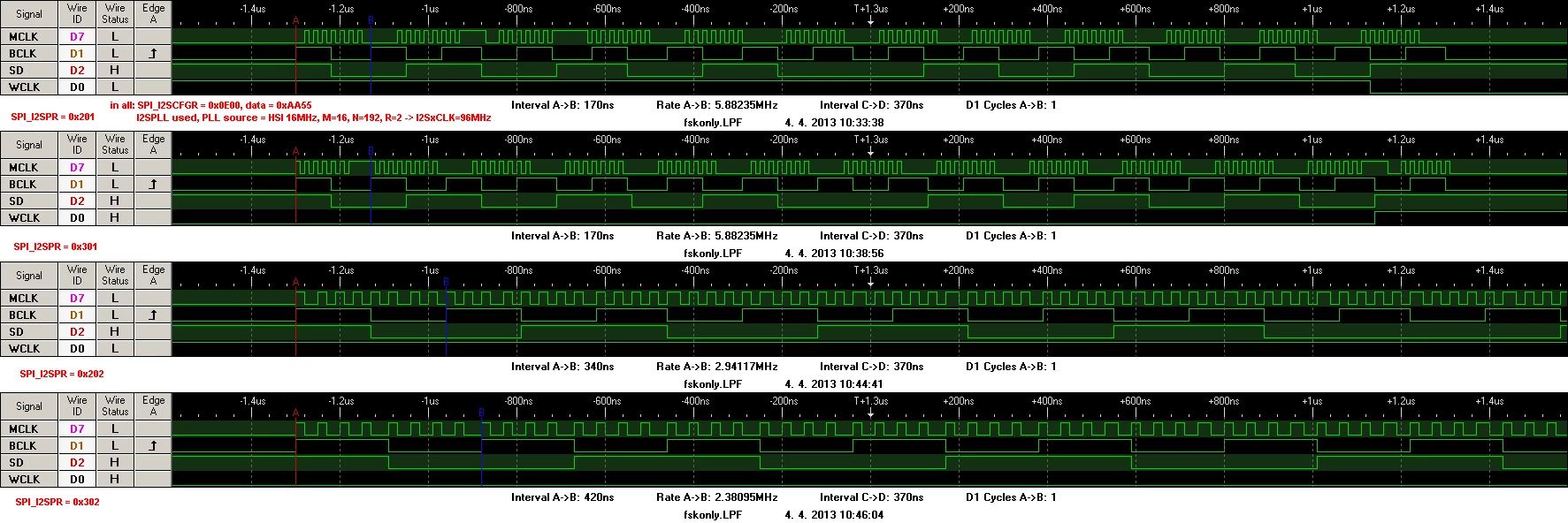

Hi friends,
It is written at ref/man for F2 and F4:
Bit 7:0 I2SDIV: I2S Linear prescaler
I2SDIV [7:0] = 0 or I2SDIV [7:0] = 1 are forbidden values.
Why ''0'' is forbidden is clear, but why ''1'' ?!
I make some intensive tests, and with I2SDIV=1 it works fine, did not see any problem.
Usially, I not like to use the components ''out of spec'', for clear reason, but I want to understand the spec.
This issue  I don't understant, so I have to decide - or use it out of spec, or to double the clock frequency Ithat increase the device' cost).
Mayby  DIV=1 has a problem only with internal PLL clock?
Thanks.
Probably not intensive enough - I do see problems - with I2SDIV=1 , ODD=1 appears to be ignored.
This is not to say that I2SDIV=1 and ODD=0 will work under any circumstances.
(The missing MCO pulses are due to sampling rate of LA set to too low - 100MHz - sorry).

Can you check with ODD=0? I do not use it.
However,  if I set DIV=1 and after this I chahged the format (I2S-LJ-RJ) sometimes I have seen the shift for a whole byte or even half-word, but if I don't change format and change Fs only - all OK.
After this I make the following:  Init I2S with DIV-2 and format setting, 5ms delay, then init I2S again, with the same format but DIV=0.
With this - never seen bit/byte/half-word shift.
All this just for fan, I'm afraid to use it in a production device, so I increase Ext.Freq twice.
The first and third waveforms were taken with ODD=0 - the whole SPI_I2SPR register is given under each waveform.
