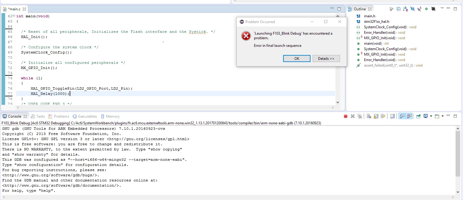

I encounter debug problems when trying  to make blink an LED of a board that include a STM32F103C8T6.
I set up the hardware firmware (GPIOs) with the program STM32CubeMx, and wrote two lines code to make the led blink:
      HAL_GPIO_TogglePin(LD2_GPIO_Port,LD2_Pin);
      HAL_Delay(1000);
Simple.
Then I build the project which was ok
But when I tried to debug here is the error message I got:
Once I run it the console message is:
Info : The selected transport took over low-level target control. The results might differ compared to plain JTAG/SWD
adapter speed: 1000 kHz
adapter_nsrst_delay: 100
srst_only separate srst_nogate srst_open_drain connect_assert_srst
Info : Unable to match requested speed 1000 kHz, using 950 kHz
Info : clock speed 950 kHz
Error: read version failed
in procedure 'program'
in procedure 'init' called at file ''embedded:startup.tcl'', line 473
in procedure 'ocd_bouncer'
** OpenOCD init failed **
shutdown command invoked
Any idea what could cause the problem?

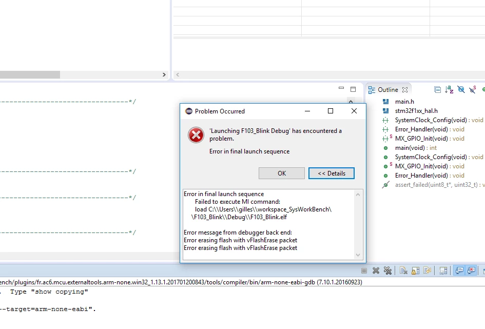

    Ok, I updated my STLINK device using STM32 ST-LINK Utility.exe but now I got this message when running debug :

    This is likely something you'd need to discuss with the Ac6 SW-STM32 support people directly. Perhaps a driver issue?

    I had a similar problem.
    See if this helps.
    1 -
    /external-link.jspa?url=http%3A%2F%2Fwww.openstmorg%2Ftiki-view_forum_thread.php%3FforumId%3D7%26comments_parentId%3D4785%23threadId7
    2 -
    /external-link.jspa?url=http%3A%2F%2Fwww.eevblog.com%2Fforum%2Fmicrocontrollers%2Fdebug-problems-with-stm32f030%2Fmsg1172575%2F%23msg1172575
    g. lewis
    g. lewisAuthor
    March 30, 2017
    Posted on March 30, 2017 at 12:44
    Ok it seems to be working now. I had to write the code: (  -c 'reset_config none' ) under openocd option int the debug configuration since my board doesn't include the hardware reset that is not connected to STlink.
    Thanks you all.

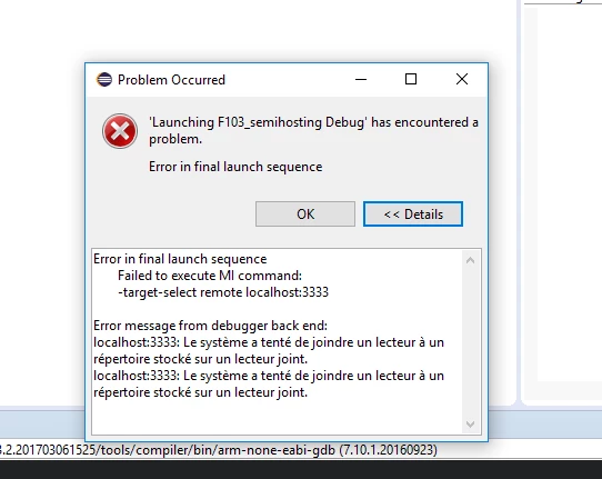

    Now I'm trying to set the semihosting mode to be able to use printf and scanf fonction and the results on the openOCD console of the SW4STM32 IDE.
    On the nucleo boards I have no diffuclty to make it work but on this type of  board where you have to hook up an external third party stlink module it doesn't work.
    I'm using the procedure for semihosting described on the help contents and SystemWorkbench for STM32/Advanced/Semihosting.
    addd:   -c ''reset_config none''  - under openocd option int the debug configuration
    And now at the debug mdoe I got this error:
    Thanks for your help.

    Oddly when I run for debug a simple Blink code I don't have errors but when using semihosting the error showes up!
    Maybe something related to debug device or interface du to the third party stlink device?
