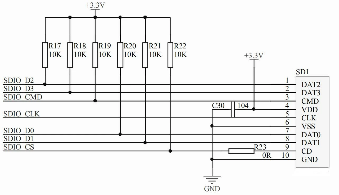

The problem is when code run to
HAL_SD_ConfigWideBusOperation(&hsd, SDIO_BUS_WIDE_4B), it always return HAL_ERROR.And then SD init failed and stuck in _Error_Handler function.

And here is my PCB SD card wiring part:

My microSD is a production of Sandisk SDHC 8GB CLASS 4. It work normally when I use card reader on PC.I even done some I/O test and capacity test on it.

I found something interesting.
In CubeMX generated code SD plug-in detecting function look like this:
uint8_t BSP_PlatformIsDetected(void) {
   uint8_t status = (uint8_t)0x01;
   /* Check SD card detect pin */
   if (HAL_GPIO_ReadPin(SD_PORT,SD_PIN) == GPIO_PIN_RESET) {
      status = (uint8_t)0x00;
   /* USER CODE BEGIN 1 */
   /* user code can be inserted here */
   /* USER CODE END 1 */
   return status;
So we know if the card detecting pin which is pin 9 in above figure connect to GND, this function will return 0. And result 0 will cause the caller function return a SD_NOT_PRESENT status.

DAHMEN.IMEN
don't know if it is a reported bug or some setting I can configure in CubeMX. Normally, we connect the CD pin to a pull-up resistor, when a card insert it connect to ground.

I simply did these two operation make my CubeMX project works.
1.Go to sdio.c file, MX_SDIO_Init(void) function, line 74,
Change this line to below:
hsd.Init.ClockDiv = SDIO_TRANSFER_CLK_DIV;   //CubeMX advised to place 0 here, but won't work for mine
2.Go to fatfs_platform.c file, BSP_PlatformIsDetected(void) function,line 53,
if (HAL_GPIO_ReadPin(SD_PORT,SD_PIN) != GPIO_PIN_RESET) { //if CD pin connect to GND,means card is inserted
Now build the the project, and FATFS will work, if your situation is the same to mine.
