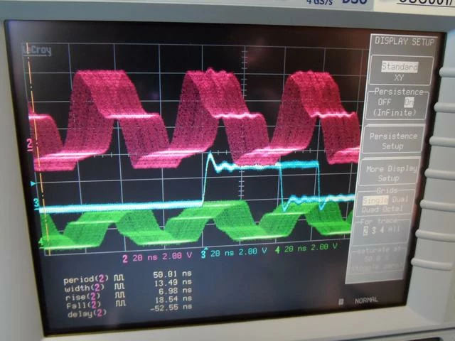

One thing I have noticed is jitter with the external clock. This is in both modes (with and without synchronisation). By attaching a scope to the external clock and the PWM output pulse, and triggeriung the scope of the PWM output pulse rising edge, I see the external clock moving back and forward. I hoped for it to be static. This suggests that the PWM isn't truly clocked off the external closk source, but is in some way sampling the external clock source.
Varying the clock source frequency doesn't change the absolute size of the jitter either which again suggests some for of high speed sampling of the external clock source.  ??The jitter seems to be about 10ns. It varies the length of the PWM pulse as the end of the pulse is better tied to the external clock ?? [I'll check this]
chrispadbury
November 29, 2012
Posted on November 29, 2012 at 12:11
It doesn't look to be better synchronised for the falling edge of the pulse.
Here is a scope trace of the issue:
The scope is set up with 20ns timebase, 2V/div and persistence so you can see the jitter. Green is the external signal generator (20MHz Square wave), Pink is the same signal measured at the board via a scope probe, and Blue is the PWM output.
As you can see from the scope image, the resulting PWM pulse, which should be one external clock cycle long (50ns), randomly adopts one of two lengths 40ns or 60ns.
The 20ns difference points at the GPIO_Speed_50MHz of all the pins used (PA8 to PA12).
chrispadbury
November 30, 2012
Posted on November 30, 2012 at 10:34
''The 20ns difference points at the GPIO_Speed_50MHz of all the pins used (PA8 to PA12).''
To investigate this I tried changing it to GPIO_Speed_10MHz and then GPIO_Speed_2MHz, neither of which made a change to the 20ns difference (and ability to externally clock the PWM at 20MHz). It still points at a 50MHz sampling, but it isn't controlled by the GPIO_InitStructure.GPIO_Speed
crt2
Visitor II
December 5, 2012
Posted on December 05, 2012 at 09:53
I took a peek at your photo and I see 2 falling edges and 2 rising edges. Rising edge is when next few samples are higher than previous one if before they were lower. Electronics inside trigger to that and same goes for falling edge. From my point of view how can you say that green or pink signals are SQUARE waves? They should look like PWM. The jitter in PWM signal can be ''supressed'' by using Capacitor (RC particle) (just the right one - you need to calculate that based on your situation).
First make waves look like you've described them (trigger waves) then I'd take a look where that 20ns sneaks in (in case it still will)
rob239955_stm1_st
Visitor II
December 12, 2012
Posted on December 12, 2012 at 11:19
Hi Chris
The cause of the jitter is likely to be:
1. The external timer input should be no faster than 1/4 of the internal timer clock, APB2, which is probably 60MHz in your system. A divider is available if your external clock is too fast.
2. The external input is re-clocked into the APB2 domain so you'll get some jitter waiting for the next clock edge.
Regards
Rob
Fen Consultants, UK
