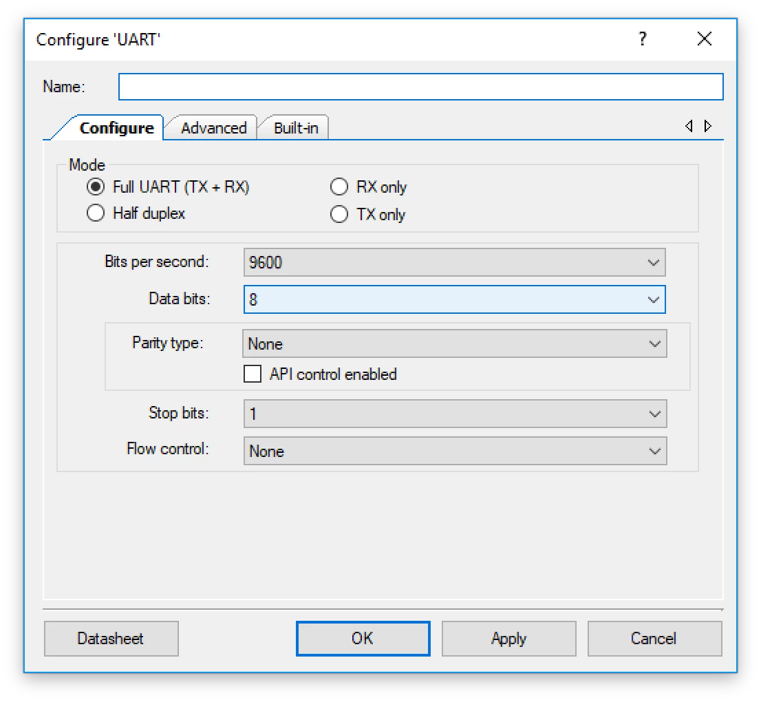

I am trying to receive data from
https://learn.adafruit.com/adafruit-ultimate-gps?view=all
, it should output 9600bd. MCU is STM32F030K6T6. Rx/Tx are crossed as they should be, connected to USART1 (PA2/PA3). I am not using any kind of HAL, just direct register access.
HCLK is HSE (8MHz crystal, 18pF capacitors). I am not using PLL.
I have tried multiple values for USART1->BRR:
  • 8 000 000 / 9600
  • 9600
  • 0x0341
Nothing works. Anything I have tried resulted in framing error.
LEDBlink.c is my code. system_stm32f0xx.c is from project template(I am using VisualGDB).
Can someone explain me what should be in BRR? Or where I could have mistake?
Thanks in advance,
Stanislav
EDIT: With these settings, I was previously able to receive data from the GPS using another brand of MCU.
#stm32f0 #uart

Ahoj,
Disable the autobaud first. You also might want to transmit a byte and check by an oscilloscope/LA whether its baudrate is set as you've expected.
Read back the USART's registers (in debugger), to check, whether they contain what you've written into them. You might need some delay between enabling its clock and writing into its registers.

waclawek.jan, thank you for reply. All registers have their values.
I have found mistake at other place. As I am new to these MCUs(actually first project), I have been following a guide. Too much. While I thought I had pins configured as alternative function, they were actually configured as analog pins.
Now I do not have framing error, now it is ORE.
How to tell USART module I don't care? Actually, I do need a full NMEA, but I do not necessarily need all of them.
Thanks in advance,
Stanislav
