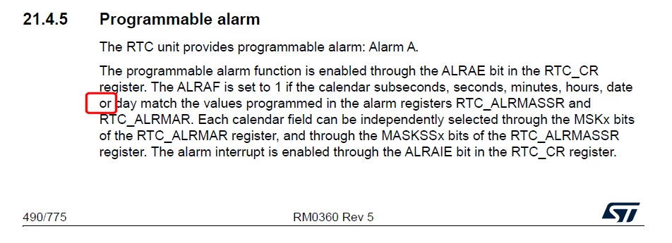

RM0360 (STM32F030x4/x6/x8/xC and STM32F070x6/xB) says:
"The ALRAF is set to 1 if the calendar subseconds, seconds, minutes, hours, date or (sic?) day match the values programmed in the alarm registers RTC_ALRMASSR and RTC_ALRMAR"
But, surely, that should be AND - not or ?
ALRAF is set to 1 if the calendar subseconds, seconds, minutes, hours, date and day match the values programmed in the alarm registers RTC_ALRMASSR and RTC_ALRMAR
https://www.st.com/resource/en/reference_manual/rm0360-stm32f030x4x6x8xc-and-stm32f070x6xb-advanced-armbased-32bit-mcus-stmicroelectronics.pdf#page=490
RM0091 (STM32F0x1/STM32F0x2/STM32F0x8) is the same:
https://www.st.com/resource/en/reference_manual/rm0091-stm32f0x1stm32f0x2stm32f0x8-advanced-armbased-32bit-mcus-stmicroelectronics.pdf#page=596

"date or day" is correct, as you can select (using RTC_ALRMAR.WDSEL), whether you want to wake up say on 15th of each month, or say Wednesday on each week. In other words, "date" here means "date-of-month", and "day" here means "day-of-week".
But I see where are you coming from: the conditions for seconds, minutes, etc. are indeed ANDed together (after being individually masked) to provide the alarm. This is IMO quite hard to formulate clearly in a narrative; perhaps something such as an equation or a schematics would be more illustrative here.
Ah - I hadn't realised that.
So the alarm is actually triggered on:
(subseconds AND seconds AND minutes AND hours) AND (date OR day)

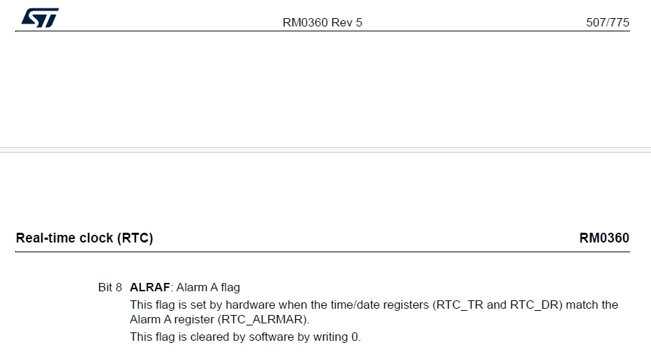

@STTwo-32  Here's another:
The description of ALRAF here omits that it also depends on RTC_ALRMSSR and, thus, RTC_SSR.
Again, RM0091 is the same.
waclawek.jan
January 9, 2025
This problem is present probably across all RMs, both RTCv2 and RTCv3 (and of course also for ALRBF where available).
Maybe at that point, it would be more appropriate not to try to explain the mechanism leading to ALRAF in detail, but to give a pointer to the respective subchapter in the narrative
