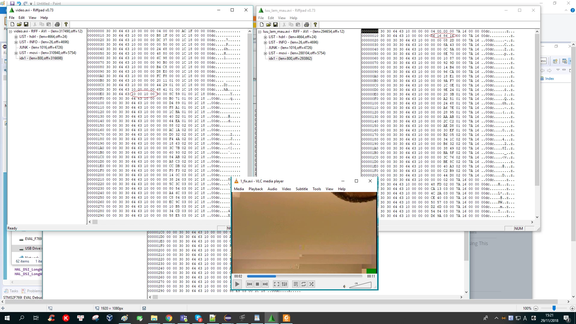

Hello, sorry for posting this post again.
I have a problem with my code. I'm trying to write a program to take picture from camera and save it as motion jpeg video (MJPEG) in to USB. I build already the header and the structure of MJPEG file but it's really weird when I try to run that avi file. Also with the source code was provided by STM, I finished to create the JPEG file.
I had checked and found out that the output data of frames and the idx1 is written by f_write was incorrect. Sometime 2 byte were written again. Someone told me maybe this problems is [3 bytes were dropped].
The header data I wrote to the begin of file is always right, but the data that I wrote to frame place and idx1 place usually has problem.
I want to write data like this below

but the output was like this
01 02 03 04 05
*01 02 01 02* 03
04 05 01 02 03
04 05 01 02 03
This link below simply show some information about MJPEG construction https://blog.goo.ne.jp/sirius506/e/442f430a1531c018a32471f1ecd4ae77

Please see the attached picture for more detail. I opened my MJPEG (avi) file by RIFF pad and it show me that the header was written into this output file was completely okay.
Anybody have experience about this? I am very appreciate with any advise.
