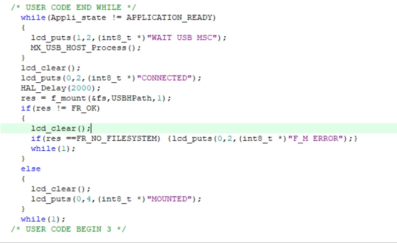

F_MOUNT RETUFN FR_NO_FILESYSTEM stm32f411 usb mass storage class
  • August 13, 2018
  • 1346 views
hello everyone.i am a new member.I am trying to read a file in usb memory. When executing F_Mount, it returns FR_NO_FILESYSTEM. If I replace 0, then this function returns FR_OK but then executes F_OPEN. This function returns FR_NO_FILESYSTEM.please help me.thank you very mucg0690X000006BsmfQAC.png

    Tesla DeLorean
    Guru
    August 13, 2018
    Please don't bump questions in this way, it's awfully presumptive.
    So behaviour is consistent the flag causes the mounting to be deferred.
    If the media is >=64GB in might well be in EXFAT format and you'll need to enable that in the configuration of FATFS. Also NTFS volumes will not be mounted.
    If the underlying read/write functions in the DISKIO layer don't return expected data/blocks then the file system will fail. You should review the data returned during initial mounting to see if it reads the MBR and BPB correctly.
