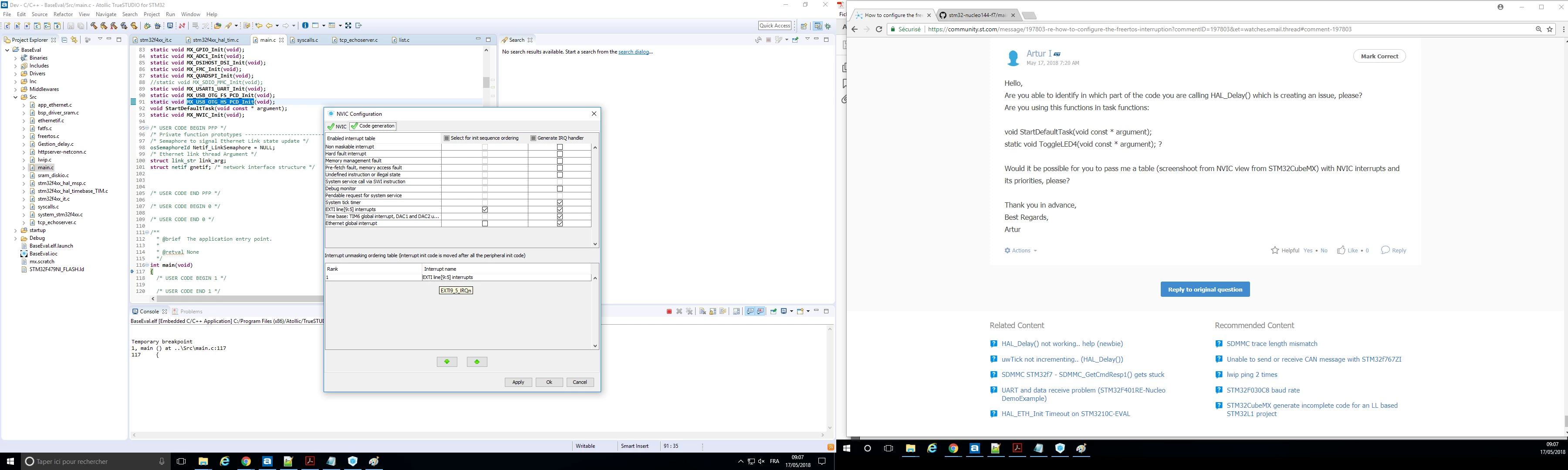

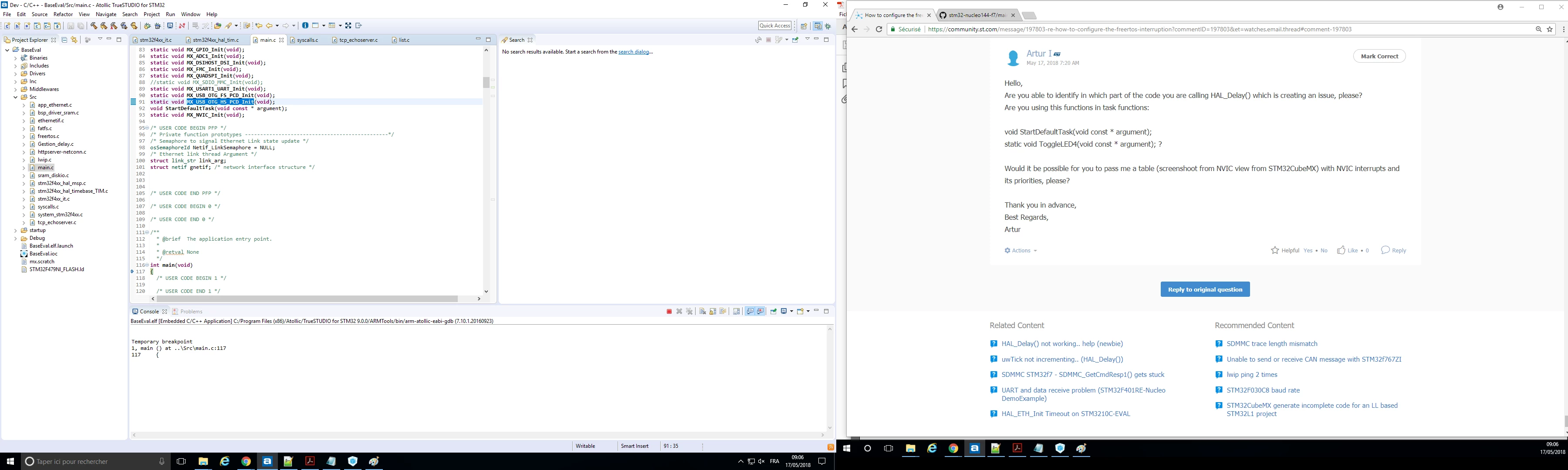

    Would it be possible for you to pass me a table (screenshoot from NVIC view from STM32CubeMX) with NVIC interrupts and its priorities, please?

    I have a question . about TIM6 I should re write the void HAL_TIM_PeriodElapsedCallback(TIM_HandleTypeDef *htim) . but I did not know how
    Y ou will find attached the NVIC ocnfiguration from STM32cubMX
    Thank you in advance0690X0000060KoYQAU.png0690X0000060Kp1QAE.png0690X0000060Kp6QAE.png
