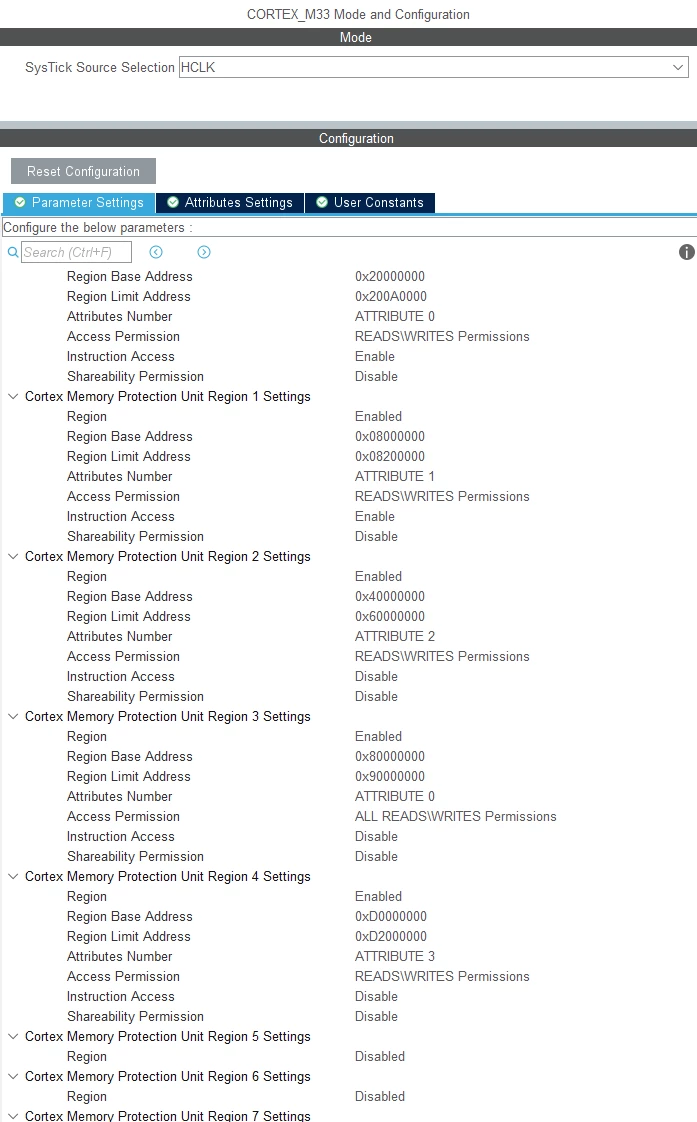

mƎALLEmBest answer
Mar 25, 2025 2:23 PM UTC
I don't know how CubeMx generated that code but to me the region N3 was set after N4. So the attributes that was set to the region 3 was net set for the region 4.
So in your MPU region 4 config add manually the MPU attribute as for the region 3 and test.

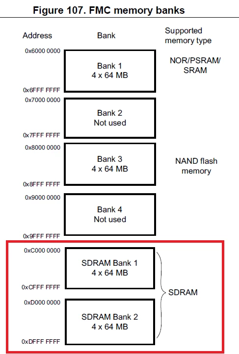

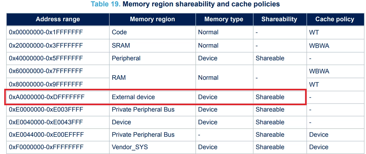

3- The SDRAM address region is located at 0xC000 0000 to 0xDFFF FFFF:
RM0481:
Which is a Non-cacheable region by default:
PM0264:
You said you configured the MPU, but did you set the SDRAM region as cacheable?

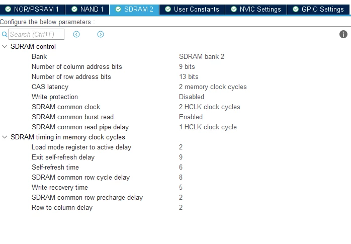

2- Did you set the same SDRAM timing for both?
yes. Here is the timing data.
// SDRAM clk = 100MHz, 10ns
// Exit Self-Refresh Delay, TXSR = 72ns, 8clk
// Self-Refresh Time, TRAS = 42ns, 5clk
// Common Row Cycle Delay, TRC = 60ns, 6clk
// Common Row Precharge Delay, TRP = 15ns, 2clk
// Row to Column Delay, TRCD = 15ns, 2clk
// Write Recovery Time, TWR = 2
// 8192 rows, refresh rate = 64ms/8192 = 7.81us
// refresh counter = (7.81 * 100) - 20 = 761
I use SDRAM bank2 on STM32H5, I think the base address is 0xD000_0000.
I tried to disable MPU, the SDRAM read/write speed looks boost to 21MB/s for read and 23MB/s for write. But it still not good enough.
while when MPU is enabled, the SDRAM read/write speed looks boost to 11MB/s for read and 11MB/s for write.

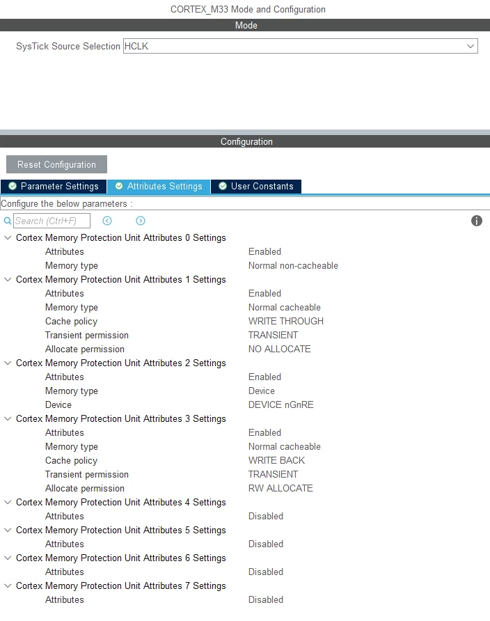

Here is the MPU_Config(), I referred AN4838 Table 9 to set MPU regions for internal SRAM, internal Flash, and Peripherals. MPU region 4 and MPU attribute 3 are used for SDRAM (0xD000_0000 to 0xD1FFF_FFFF). The region is set to instruction disable,  inner-sharable, normal-cachable, write-back, transit, and rw-allocate.
void MPU_Config(void)
 MPU_Region_InitTypeDef MPU_InitStruct = {0};
 MPU_Attributes_InitTypeDef MPU_AttributesInit = {0};
 /* Disables the MPU */
 HAL_MPU_Disable();
 /** Initializes and configures the Region 0 and the memory to be protected
 MPU_InitStruct.Enable = MPU_REGION_ENABLE;
 MPU_InitStruct.Number = MPU_REGION_NUMBER0;
 MPU_InitStruct.BaseAddress = 0x20000000;
 MPU_InitStruct.LimitAddress = 0x2009FFFF;
 MPU_InitStruct.AttributesIndex = MPU_ATTRIBUTES_NUMBER0;
 MPU_InitStruct.AccessPermission = MPU_REGION_ALL_RW;
 MPU_InitStruct.DisableExec = MPU_INSTRUCTION_ACCESS_ENABLE;
 MPU_InitStruct.IsShareable = MPU_ACCESS_NOT_SHAREABLE;
 HAL_MPU_ConfigRegion(&MPU_InitStruct);
 /** Initializes and configures the Region 1 and the memory to be protected
 MPU_InitStruct.Number = MPU_REGION_NUMBER1;
 MPU_InitStruct.BaseAddress = 0x08000000;
 MPU_InitStruct.LimitAddress = 0x081FFFFF;
 MPU_InitStruct.AttributesIndex = MPU_ATTRIBUTES_NUMBER1;
 /** Initializes and configures the Region 2 and the memory to be protected
 MPU_InitStruct.Number = MPU_REGION_NUMBER2;
 MPU_InitStruct.BaseAddress = 0x40000000;
 MPU_InitStruct.LimitAddress = 0x5FFFFFFF;
 MPU_InitStruct.AttributesIndex = MPU_ATTRIBUTES_NUMBER2;
 MPU_InitStruct.DisableExec = MPU_INSTRUCTION_ACCESS_DISABLE;
 /** Initializes and configures the Region 3 and the memory to be protected
 MPU_InitStruct.Number = MPU_REGION_NUMBER3;
 MPU_InitStruct.BaseAddress = 0x80000000;
 MPU_InitStruct.LimitAddress = 0x8FFFFFFF;
 /** Initializes and configures the Region 4 and the memory to be protected
 MPU_InitStruct.Number = MPU_REGION_NUMBER4;
 MPU_InitStruct.BaseAddress = 0xD0000000;
 MPU_InitStruct.LimitAddress = 0xD1FFFFFF;
 MPU_InitStruct.AttributesIndex = MPU_ATTRIBUTES_NUMBER3;
 MPU_InitStruct.IsShareable = MPU_ACCESS_INNER_SHAREABLE;
 /** Initializes and configures the Region 7 and the memory to be protected
 /** Initializes and configures the Attribute 0 and the memory to be protected
 MPU_AttributesInit.Number = MPU_ATTRIBUTES_NUMBER0;
 MPU_AttributesInit.Attributes = INNER_OUTER(MPU_NOT_CACHEABLE);
 HAL_MPU_ConfigMemoryAttributes(&MPU_AttributesInit);
 /** Initializes and configures the Attribute 1 and the memory to be protected
 MPU_AttributesInit.Number = MPU_ATTRIBUTES_NUMBER1;
 MPU_AttributesInit.Attributes = INNER_OUTER(MPU_WRITE_THROUGH|MPU_TRANSIENT
 |MPU_NO_ALLOCATE);
 /** Initializes and configures the Attribute 2 and the memory to be protected
 MPU_AttributesInit.Number = MPU_ATTRIBUTES_NUMBER2;
 MPU_AttributesInit.Attributes = MPU_DEVICE_nGnRE;
 /** Initializes and configures the Attribute 3 and the memory to be protected
 MPU_AttributesInit.Number = MPU_ATTRIBUTES_NUMBER3;
 MPU_AttributesInit.Attributes = INNER_OUTER(MPU_WRITE_BACK|MPU_TRANSIENT
 |MPU_RW_ALLOCATE);

mƎALLEm
Mar 25, 2025 12:40 PM UTC
1- For the performance comparison you need to set the system at the same config (compare like with like): same clock, same timings etc ..
2- As I can see, you didn't set the region 0xDxxx xxxx cacheable:
You didn't set the parameter MPU_AttributesInit.Attributes for that region to be cacheable and you didn't set it before. So 0xDxxx xxxx still not cacheable.
