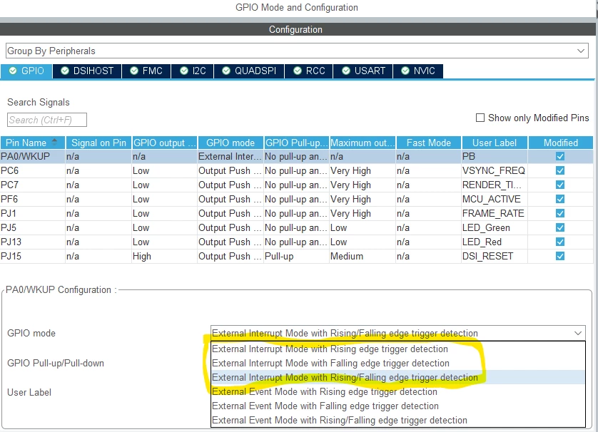

I'm trying to setup interrupts using the user push button (B1) on the Nucleo-F429ZI board. The push button is connected to the microcontroller through the I/O line PC13.
What I did is that I mapped the PC13 to the GPIO_EXTI15 in STM32CubeMX and enabled the NVIC interrupt for EXTI15_10. Then I regenerated the code which gave me the following function in main:
 /* GPIO Ports Clock Enable */
 __HAL_RCC_GPIOC_CLK_ENABLE();
 /*Configure GPIO pin : PC13 */
 GPIO_InitStruct.Pin = GPIO_PIN_13;
 GPIO_InitStruct.Mode = GPIO_MODE_IT_RISING;
 HAL_GPIO_Init(GPIOC, &GPIO_InitStruct);
 /* EXTI interrupt init*/
 HAL_NVIC_SetPriority(EXTI15_10_IRQn, 0, 0);
 HAL_NVIC_EnableIRQ(EXTI15_10_IRQn);
I call it in the main after initializing the clocks. However, after the function has been executed, pressing the button does not trigger an interrupt. I enabled interrupt tracing and I can see that the interrupt is never triggered and my callback is therefor never called.
Did I do something wrong ? Thank you.

Besides enabling NVIC, did you enable for External Interrupt Mode?
If a reply has proven helpful, click on Accept as Solution so that it'll show at top of the post.CAN Jammer an open source CAN bus hacking toolCANableV3 Open Source
Fnx_QT
Fnx_QTAuthor
January 11, 2023
If by enabling External Interrupt Mode you mean enable EXTI line[15:10] interrupts in the NVIC Interrupt Table, then yes.
If you mean another thing, then I don't what it is and I'm interested.
Karl Yamashita
Principal
January 11, 2023
Enabling EXTI line[15:10] is 1 of 2 things that needs to be enabled. I believe by default External Event Mode is enabled but you want External Interrupt Mode.
Fnx_QT
Fnx_QTAuthor
January 11, 2023
Oh and if you meant setting the GPIO mode to External Interrupt Mode with Rising/Falling edge trigger detection, also yes. I tried both with Rising and Falling edge, and both failed.
Karl Yamashita
Principal
January 11, 2023
I posted before I saw this post, but yeah that is what I was talking about.

Fnx_QT
Fnx_QTAuthor
January 12, 2023
Using the debugger I can see that the bit IDR13 in GPIOC is set everytime I press the button and unset as soon as I release it.
In the EXTI registers I can also see that the IMR (Interrupt Mask Register) is set to 1 for line 13, thus not masking interrupt from line 13.
The RTSR (Rising Trigger Selection Register) is set to 1 for line 13, so rising trigger exception are enabled.
The FTSR (Falling Trigger) is set to 0 for line 13.
Software Interrupt Event Register (SWIER) is set to 0 for line 13.
The Pending Register (PR) is set to 1, it's interesting cause I cannot disable it, it reenables itself directly if I uncheck it.

I finally found the problem... All the configuration was good, the only thing that broke my system was a preprocessor symbol define that was included in my example project : CMSIS_NVIC_VIRTUAL HSE_VALUE=8000000. I still don't know what purpose it serves.
In addition, the cmsis_nvic_virtual.h was used and some NVIC functions were redefined:
#define NVIC_SetPriorityGrouping __NVIC_SetPriorityGrouping
#define NVIC_GetPriorityGrouping __NVIC_GetPriorityGrouping
#define NVIC_EnableIRQ(IRQn) svcNVIC_func(2U, IRQn)
#define NVIC_GetEnableIRQ __NVIC_GetEnableIRQ
#define NVIC_DisableIRQ(IRQn) svcNVIC_func(4U, IRQn)
#define NVIC_GetPendingIRQ __NVIC_GetPendingIRQ
#define NVIC_SetPendingIRQ __NVIC_SetPendingIRQ
#define NVIC_ClearPendingIRQ(IRQn) svcNVIC_func(7U, IRQn)
#define NVIC_GetActive __NVIC_GetActive
#define NVIC_SetPriority __NVIC_SetPriority
#define NVIC_GetPriority __NVIC_GetPriority
#define NVIC_SystemReset __NVIC_SystemReset
Upon removing these two modifications, the button interrupt is now working correctly.
Thank you all for your help.
