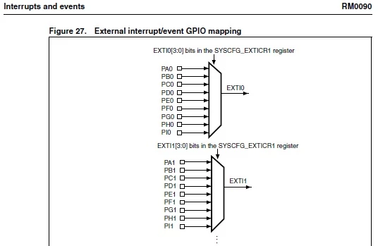

I want to edit and use the example of EXTI PA3, but it does not work, what am I doing wrong?
    It ain't LINE 0 / EXTI 0 anymore.

    If I understand correctly PA3 is not connected to EXTI line 0?
    could you tell me where to find a table or something similar indicating EXTI_LINE and pin to which it is associated? I looked in the manual but could not find, maybe try with the wrong name or something.

    Px3 goes to EXTI3

    thanks Clive!
