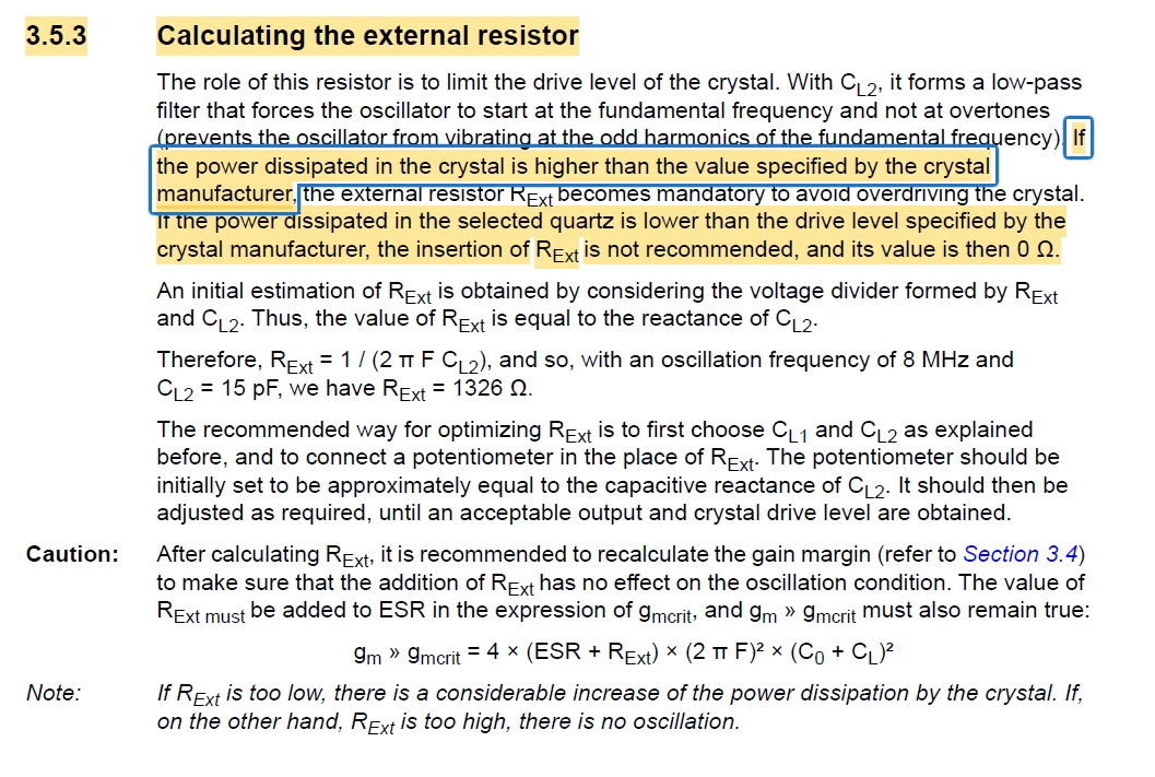

Hi, I have a question about this highlighted text in the AN2867 document refering to the "calculating external resistor" paragraph
As I understood the condition to use a Rexternal is "if the power disipated in the crystal is higher than the value specified by the crystal manufacturer", as shown above so my question is how to check the power dissipated in the crystal? how to know if I`ll need to use Rext before have a physical implementation of my MCU thanks for your help

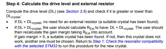

1_ You refer to the AN2867. The way to choose external crytals in explained step by step in chapter 4, and more specific is the step 4 of 4.2 chapter about Drive Level.
To check drive level, refer to section 3.5.1 or 3.5.2  if applicable for you.

Hi @GET  thanks for your time.
Reading the docummentation you recommend me I realized that; to know if an Rext is necessary we need the physically use an oscilloscope to measure the current trougt the crystal or the voltaje on it,  just to be sure, is this correct??
I thought I t would be possible to define if a Rext will be used without any physical measurement.

Hello @Aldo_Flores_Aguayo ,
I can conclude like what you say : there are two options described in AN2867, in 3.5.1 and 3.5.2, and both need measurements. I am not aware of any other possibility or other document describing other method on this subject.

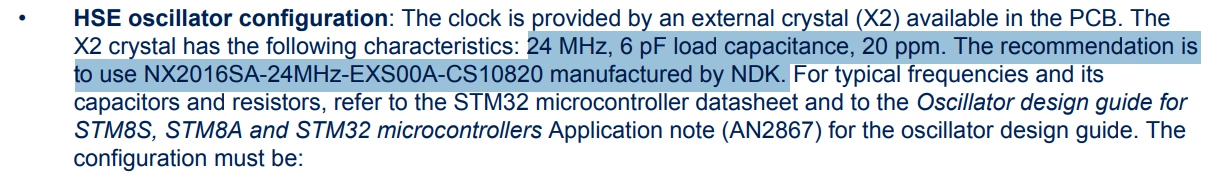

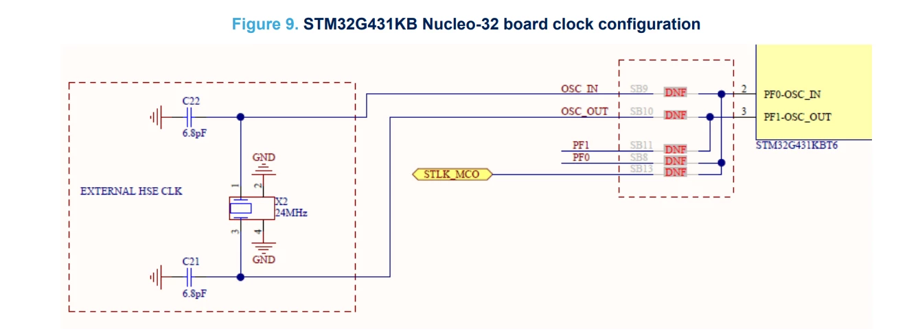

Just want to let you know that I´m using another strategy lets say, what I did was to look for some board that implemented a crystal oscillator in the same same range as the MCU I´m triying to implement (STM32L4P5RGT), then looking at the MCU implemented in that development board, search for it´s datasheet and find the "transconducance value" of that MCU, once I verified the transconductance value was the same as the one in my application MCU, I look for the documentation of the board and look on how they design the oscillator, luckily I found this (STM32G431KB Nlucle--32 Board)
They comment the following about the oscillator they implemneted
And what I´m planning to do is to use the same crystal model (or some one with same characteristics ESR, Freq, CL, etc) and implement it as they show on the image above but to my own MCU (that technically has the same Maximum critical crystal transconductance ) , is this correct to do? what do you think?
One more questions what does the dotted square means in between the MCU oscillator pins and the external crystal configuration??
