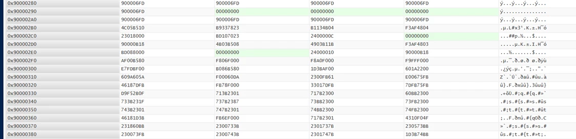

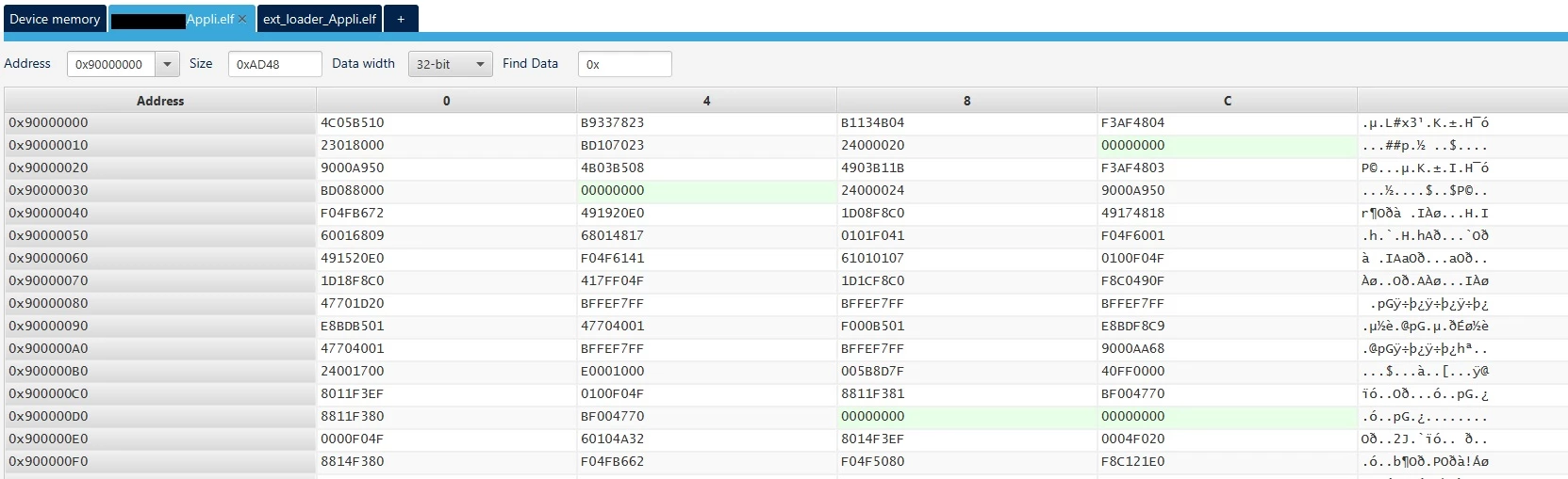

I am trying to port an existing design that did not use the external memory loader into a version where I can use the external memory loader so that I can add additional code.

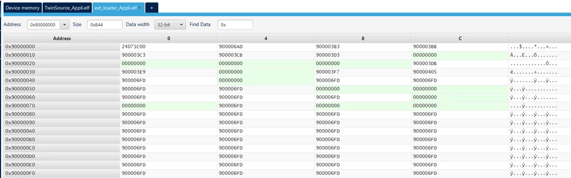

I watched the videos and read the materials and have successfully made the example version that works. Looking at the memory at 0x9000_0000 I see the following
However, when I attempted to build a version by porting all my code into a fresh build I get a external memory which appears to be missing data from 0x9000_0000 to 0x9000_02b0. In other words the data in the above ext_mem_loader example at 0x9000_02b0  appears at 0x9000_0000 in the Appli version. The Appli version jumps to 0xF3AF4804 which is bad

Thanks for the references. I am looking into them. Seems like the MX tool did not add the .isr_vector in the loader.
After manual editing post MX I am able to get the program running from external Flash. I do not know why the MX tool would not add the .isr_vector in the loader but, time permitting,  I will post details on what I had to do as a work-around.
