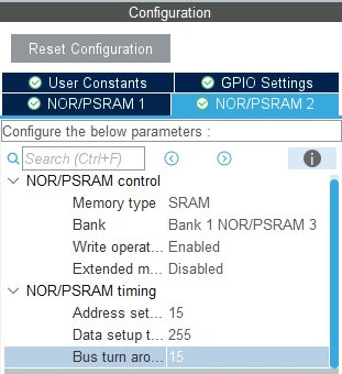

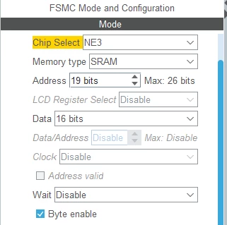

I have a board with the STM32F407ZGTx, which has space for an SRAM/PSRAM expansion, using IS62WV51216BLL-55TLI. I installed it, everything was fine.
I worked with the old 68000 processor, which had 2 signals, UBS and LBS if I'm not mistaken. Upper Byte and Lower Byte. It was 16 bits too... and I could create a char* variable (C++) in memory, and it would write normally to even and odd addresses (even addresses were d8-d15 and odd addresses were d0-d7). Well, here, on the STM32, it seems that the NBL[0-1] signals are useless. I set byte access (as in the images), configured everything, and it only writes 16 bits.
I made a small test program below, and it doesn't work. It seems that it always writes 16 bits. Could someone help me?
I want to do the basics. A char* variable, write sequentially, and read later in the same way. I thought the FSMC did the same thing as the 68000, since it works with memory.
I even looked and searched on the NET, even in an Article, like the one attached, and the explanation is minimal of how byte mode NBL[0-1] works, that's why I'm asking for help:

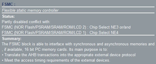

PS: I also have the NE4 which is the LCD, and the warning message I attached appears. But I'm ignoring it, since they share pin resources, and won't be working on the same pins at the same time. What makes me suspicious now is that the LCD only uses D0 - D7, but since it's not selected, its pins are in 3-state. I don't think that's it.

Guys, I've been burning my brain here, and after I posted the last message, I remembered: The TFT LCD may be interfering, it also uses FSMC and NE4. So I removed everything from the project, tested it with a clean board and... voilà, everything worked... The memory is 100%... I tested it all... it's just the TFT LCD...
Now I need to know if it's the driver, or if it's the LCD itself.
