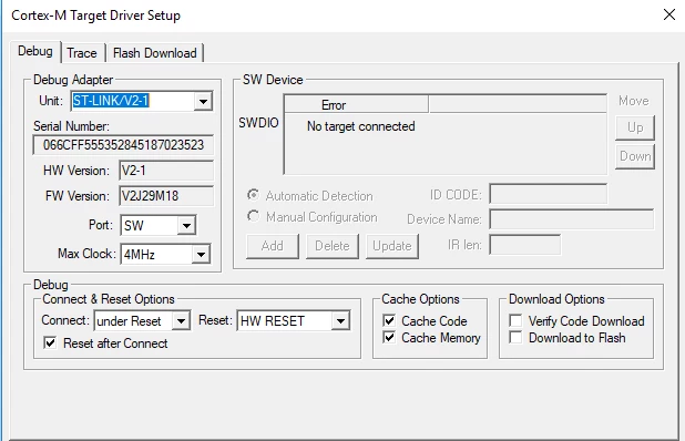

I've an Nucleo-f091rc, and i need using this board to programming an external STM32F070, using SWDIO, I've connected SWDIO, SWDCLK, NRST and GND. My external MCU have external 3.3V. When I try to connect I receive the mesage No target connected.

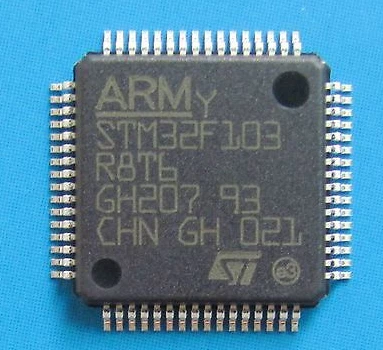

    Pin 1 is the smaller, concave mark in the lower-left, and I'm using the pin 1 on
    larger mark in the upper-right.
    Anyway my external MCU works  fine now.

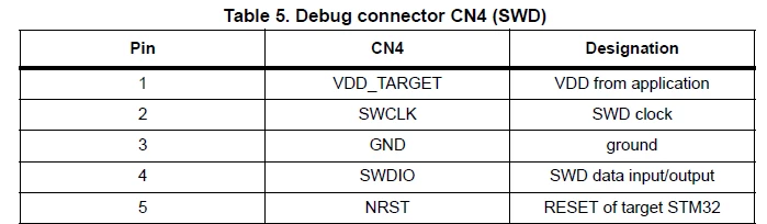

    Have you verified your wiring with an ohm-meter (or something similar) down to the pin of your target ?
    Aren't you wires too long ?
    I've an Nucleo-f091rc, and i need using this board to programming an external STM32F070, ...
    The Nucleo user manuals use to have a section about debugging external targets, did you follow it ?

    Hello AvaTar,
    I'm working with this 2 days. I have read a lot of simililar issues like my.
    ''The Nucleo user manuals use to have a section about debugging external targets, did you follow it ?''
    Yes, I did.
    the boot0 pin have a 10k with the GND.
    All VDD and VDDA have a 100nF
    VSS and VSS is plug on GND
    I'm try using Keil to debug

    If you have removed the jumpers on the Nucleo then the next most probable cause is the target isn't correctly powered.
    Check VDDA connection
    Check part orientation
    Check NRST state
