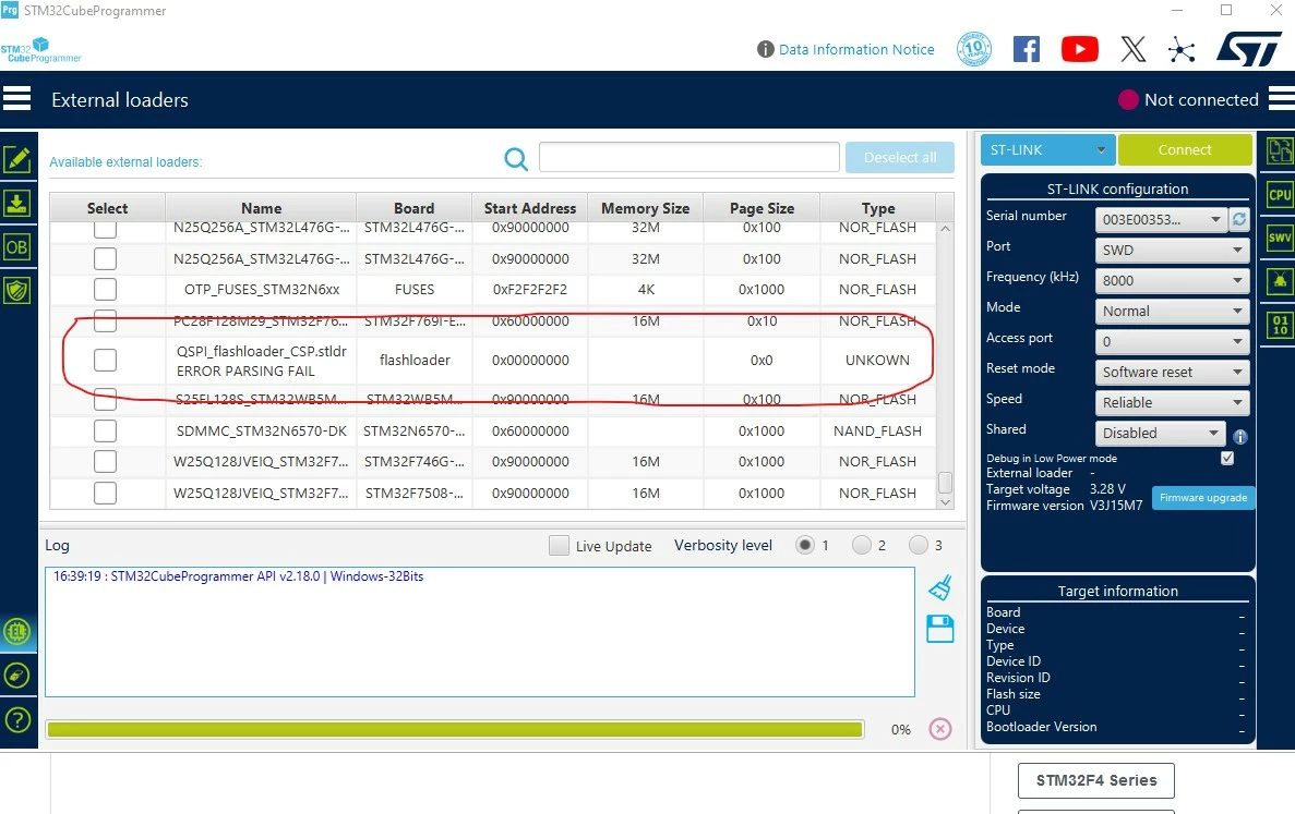

I am attempting to make an external loader for a QuadSPI flash S25FL256SAGMFI000 using the STM32F769 and STM32CubeIDE.
I followed this tutorial: https://www.youtube.com/playlist?list=PLnMKNibPkDnHIrq5BICcFhLsmJFI_ytvE
I was able to run the code to the end of the while loop like described in the video and successfully wrote/read to memory at address 0x90000000.
I am able to generate an stldr file, but when I try to load it in the CubeProgrammer the file displays the error "ERROR PARSING FAIL". The programmer also does not display the right start address, the memory size, page size, or type, which leads me to believe there is a problem with the Dev_Inf.c file.
Has anyone seen this error before and can steer me in the right direction of where to look to correct it? I have attached the Dev_Inf.c, Loader_Src.c, and quadspi.c files. Please let me know what other files I can attach for review.
Thank you!

Start with the .ELF / .STLDR, inspect with tools like OBJDUMP, FROMELF or OBJCOPY, try to understand how the form differs from those that load/work properly.
Make sure it's exporting the expected functions, and builds for RAM at 0x20000004
Check also the Linker Script, .LD

The design of the cores and peripherals doesn't exactly make these things portable at a binary level. I'd have to back-port the SPANSION support into my build.
The .ELF object describes several sections that pull into memory, with symbols identifying the entry points, the data/size of StorageInfo typically driving the user interface in the External Loader menu, but it might be looking for Init, Write, SectorErase, etc.

Is there anything I can see in the .ELF that would indicate that it isn't loading the information from the Dev_Inf.c/h files?
Tesla DeLorean
Guru
December 19, 2024
Well dumping out the content of the data records describing StorageInfo should allow you to confirm the data in Dev_Inf.c is correctly reflected in the structure.
If you look at things that are working successfully, you can contrast that to the one that's not viable.
Is this really how you have the part wired? Is that viable? Have you programmed the part from application space?

The pinout does work, I am using the STM32F769IIT6. I am able to execute example code in the debug mode to erase, write and read contents or the flash successfully. I will have to look at the .elf file. I need to download KEIL MDK to get the fromelf.exe program.
Just an observation; the contents for the Dev_Inf .cyclo and .su files in the release folder are empty. Looking at other files, this doesn't seem normal. Could that be part of the problem?
