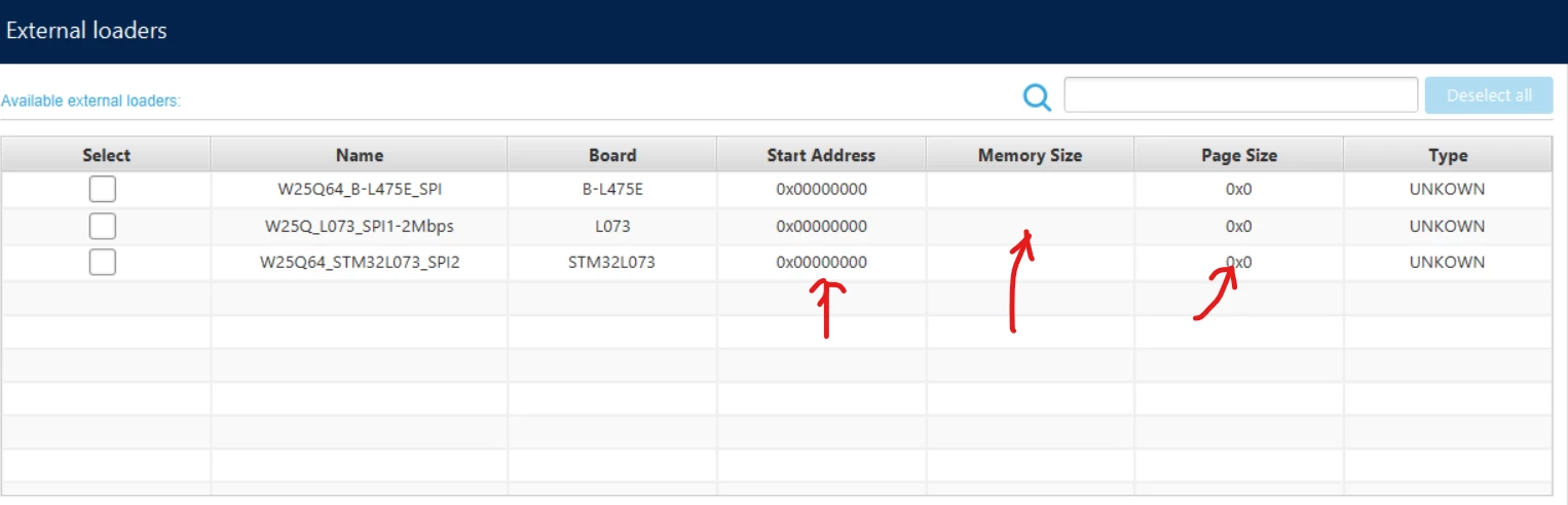

Hi I am using Stm32L0 series board to create a custom external loader. I am using cubeIDE (version: 1.16.0)
I am using winboard W25Q64 chip. I wrote a driver for this chip and interfaced it to my mcu using standard SPI2. I can read /write data on this external flash without any issue.
Next step is to create an external loader.
I tried to create the external loader, initially I was getting "Error Parsing Fail" issue but then I added some padding bytes to my struct which resolved the problem.
Now I can compile the external loader without any issue and I can use it to read data from address 0x0 using cubeProgrammer. I can read roughly 8192 bytes from starting address 0x0.
However I cant write data into the memory using external loader. One thing to note that cubeProgrammer is not showing my memory size and my memory type is also appearing as unknown:

I have tried different boards and also different version of cubeProgrammer (2.17.0 as well as 2.14.0) but this problem is not going away. For some reason cubeProgammer is not able to retrieve the correct information about my page size, my memory type, memory size and also start address.

I managed to resolve the problem. Issue was in my structure, i redefined my structure and it resolved the problem.
