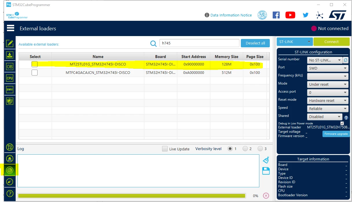

Could you please try to use "MT25TL01G_STM32H745I-DISCO.stldr" under STM32CubeProgrammer path "...\STM32CubeProgrammer\bin\ExternalLoader".
I think it will work because the MT25TL01G_STM32H745I-DISCO" [support memory Size = 128M] for your QSPI memory and MT25QL512A [memory Size = 64MB]. So, the size of your memory is less than the external loader supported by STM32CubeProgrammer.

using MT25TL01G_STM32H745I-DISCO.stldr following are the observtions
1. The programming is successful but the verification fails
2. The mass erase completes in only 3 seconds which should take around 3-7 min so it is not erasing.
3. Read back programmed data and when compared to the binary, the data does not match.
4. Erasing sectors completes sucessfully but with a message that protected sectors are not erased. If data is read again after erase it is not 0xff so erasing is not happening maybe due to protected sectors
Maybe need to debug and check in code on whether the sectors are protected
