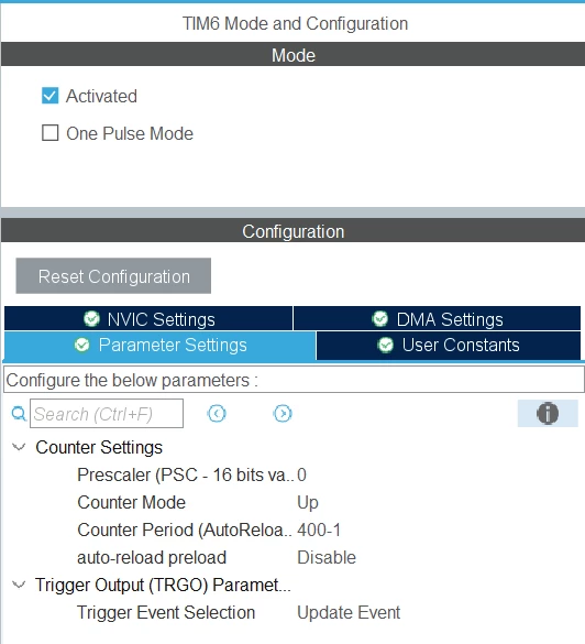

I'm using the NUCLEO-H743ZI2 board and I'm trying to interface it with an external DAC MCP4922 via SPI.

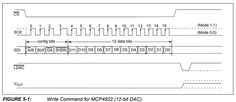

As explained in the documentation, the CS pin is very important because it is used to mark the end of a transmission for the DAC to put the received value on its output.
The problem with this CS validation pin is that I can't use a SPI circular DMA with multiple values as I first imagined to do because in this case, the Hadrware NSS Output Signal configurable in the .ioc doesn't work as I would like (between each data).
My actuel program is then working like this:
I use a timer that I configure to my aimed sampling rate. I use his PeriodElapsedCallback to send a SPI frame to my DAC.
Here are some snippets of what I've done:

CONFIGURATION:
SYSCLOCK fixed to 480MHz
APB Timer clock fixed to 120MHz

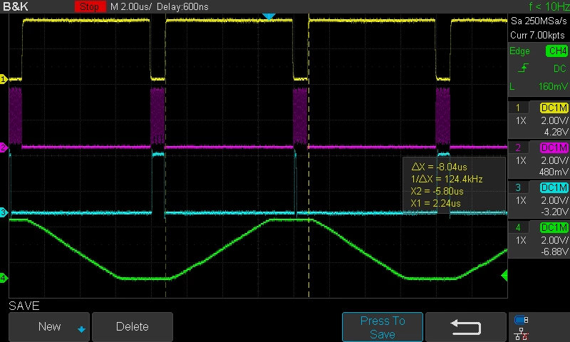

Really easy but way to slow! When I configure my timer to go >≈ 130kHz ( 300kHz on the above screenshot)
SPI transmit doesn't follow and I have a huge gap between every sending!

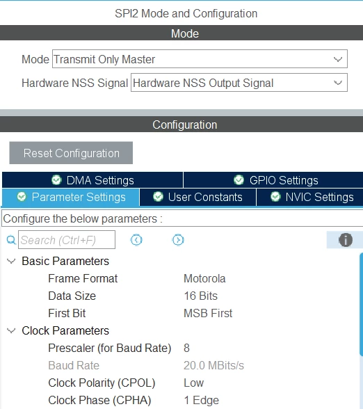

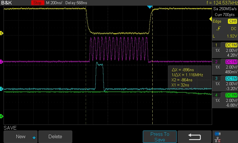

     Figure 1 shows the SR limit I reach                  Figure 2 shows a typical SPI transmit with a 20Mhz speed
yellow: CS / purple: SCK / blue: MOSI / green: CHANNEL_A DAC output.
I made some research on the forum and found several discussions with similar issues. I've tried implementing some of them but I haven't been able to get them to work... As I'm still junior, I might be misunderstanding certain aspects and there are many things I still have to learn! I'de really appreciate any help!

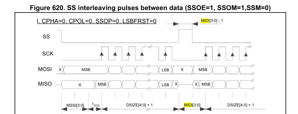

Master Inter Data Idleness can be used to have CS pulse high between words.

jmFAuthor
March 13, 2025
Thank you very much @TDK, I managed to reach the aimed SR with this solution!
I would have a second question:

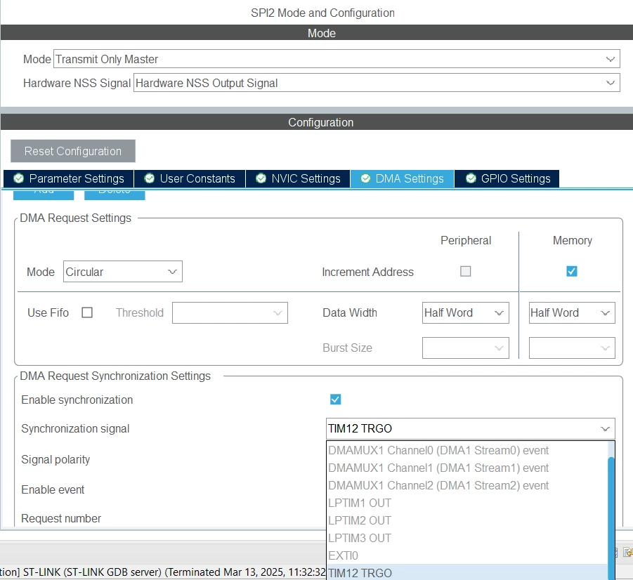

Including your solution, I have set up circular DMA on my SPI connection. Because I want to precisely be master of the SR of my DAC, I use synchronization signal of a timer. The problem is that I don't have other choice than TIM12.
I would like to be able to use an other timer (TIM6 for exemple), maybe I could use proposed DMAMUX but I really don't know how it works.
Could you point me toward a solution or some ressources to achieve this?
