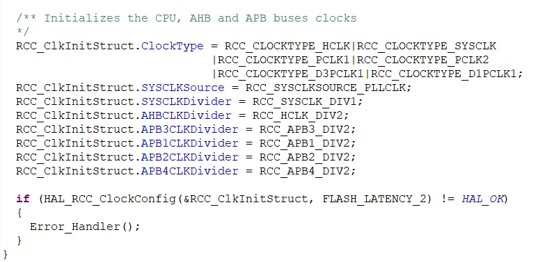

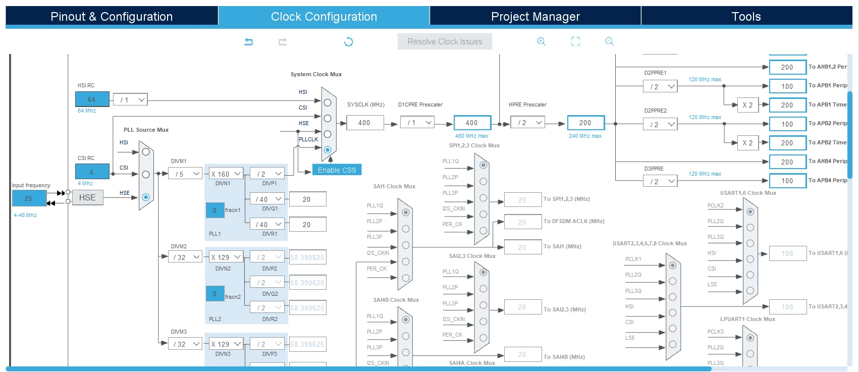

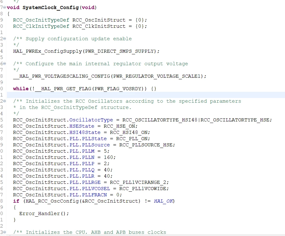

I have custom board. I am working on STM32H7 controller. We use the external crystal of 25Mhz. But when we use that external oscillator using the HSE ,it doesn't provide the clock to controller. Why these happening. Can you please help me
