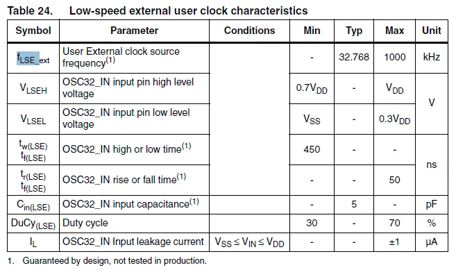

Connectivity via MCO, TIM5 and TIM11
waclawek.jan
April 8, 2013
Posted on April 08, 2013 at 16:47
It's not a coincidence that this table is found under ''Low-speed external user clock generated from an external source'' header.
I'd be very surprised if this would constitute a guarantee that the LSE circuitry can drive a 512kHz crystal.
