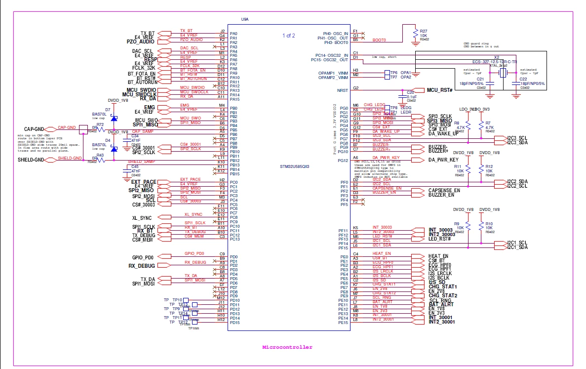

Ephraimoved
September 6, 2022
Hi.
It is a custom board .
Attached schematic of CPU.
On one board PA8 produce 32.768 khz. On other board the CPU is stuck .

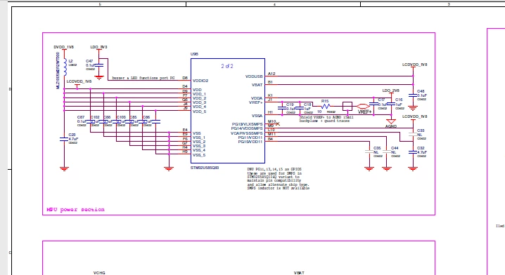

Ephraimoved
September 6, 2022
waclawek.jan
September 6, 2022
Use longer or infinite timeout, LSE startup may take tens of seconds. Try different LSE drive strength, see RCC_BDTR. Read AN4759.
