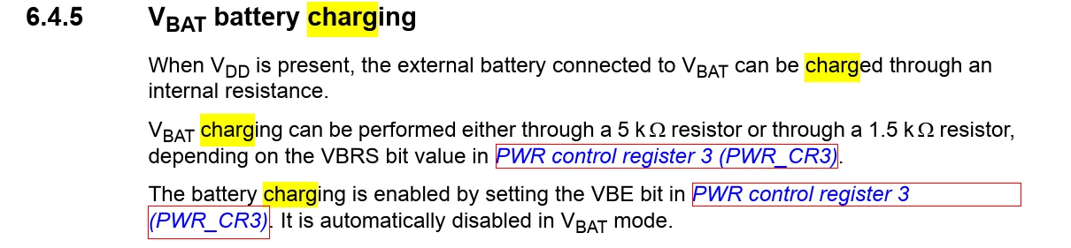

And : if osc is low power (it is - right ? ) then could run just on Vbat and switch on charging from cpu .

>I use non-rechargeable battery so, recharging is not possible.
Me too.  :)
But anyway...try it. (With 5k charge setting you cannot explode anything...)
With almost new LI-cell, about 3.1 V , and 3v3 supply , the 5k "charging" will be 40uA to the battery + osc.
If new cell, about 3.2V , current down to 20 uA .
