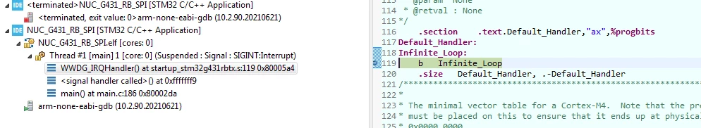

Ext Interrupt works fine in dedicated project, but does not when copied into the main project
I have this code, in where the interrupt works without issues in debug mode:
void EXTI2_IRQHandler(){
	SET_BIT(EXTI->PR1, EXTI_PR1_PIF2); // Clear interrupt flag

 But when put into the main project, it gives me an error, as if the interrupt routine was never defined.

Found the solution already:
I have copied the routine in another file. I put the declaration too, but it didnt work.
It workes like this (adding the extern "C"):
#ifdef __cplusplus
 extern "C" {
#endif
void EXTI2_IRQHandler(void);
