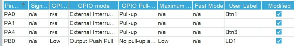

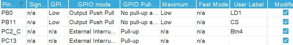

Hello, I'm using H723 Nucleo. I set 5 ext interrupt pins: PA0, PA1, PA4, PC2_C, and PC13 as EXTI to 5 switches, enabled NVIC interrupt, GPIO pull-up,  interrupt with rising edge triggered, and tied these 5 pins to switches with the other end to ground. The code is working fine, but I observe that only 1 interrupt (either 1 of the 5 switches) can work at any one time, and all 5 interrupts cannot work together at any instance... is this interrupt conflict on H7? Anyone can advise?

Hi i had checked and re-check the Pins assignment as screenshot and code below:
void HAL_GPIO_EXTI_Callback(uint16_t GPIO_Pin)
	if (GPIO_Pin == Btn1_Pin) // PIN_0
		// LED1 on
	else if (GPIO_Pin == GPIO_PIN_1)
		// LED2 ON
	else if (GPIO_Pin == Btn2_Pin)
		// LED 3 ON
	else if (GPIO_Pin == Btn3_Pin)
		// LED3 ON;
	else if (GPIO_Pin == GPIO_PIN_13)
		// LED 4 ON
below,

November 13, 2024
Hello @HMSEdinburge ,
First, I have remarks regarding the info you provided:
 -> You set pull up and you set the EXTI edge to rising which is not correct. You need either to set pull-up resistor and set the edge to falling or set pull-down resistor and set the edge to rising.
PA1 is connected to the ETH PHY RMII_REF_CLK pin on the board. need to select another pin. PC13 is used by the user button which has already an external pull-down resistor. So no need to set pull up/down internal resistor.
Now regarding the code, this is how it could be managed:
 switch(GPIO_Pin)
 case GPIO_PIN_0: exti_source = 1; break; // PA0
 case GPIO_PIN_3: exti_source = 2; break; // PA3 instead of PA1
 case GPIO_PIN_4: exti_source = 3; break; // PA4
 case GPIO_PIN_2: exti_source = 4; break; // PC2_C
 case GPIO_PIN_13: exti_source = 5; break; // PC13
 default: exti_source= 0; break;
I've attached a project running on NUCLEO-H723 that uses all these EXTIs (just replaced PA1 by PA3) . Put exti_source in live watch and you can see the value that changes according to the EXTI event triggered.
Hope that answers your question.
