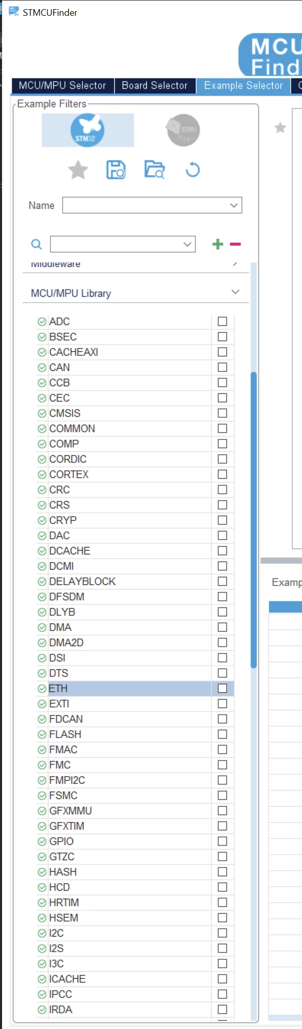

Explanation of samples/library names?
in the MCU selector app, in the Example selector, there is a long list of examples, all using acronyms (see screenshot below). Some are obvious like "ETH" but most are not.
Some questions:
1) Where can I find a table/list that explains what each of the acronyms mean?
2) Where can I find the actual code for each?
3) which one is USB bootloader and SDMMC bootloader?
4) which one is USB mass storage device?
Thank you :)

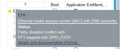

1- In the reference manual of the product:
Example:
Or move the cursor on it:
2- In the Driver folder.
3- There is no bootloader code generated by CubeMx. It's under the user responsibility.
4- No mass storage code generated by CubeMx at this level. You need to configure the interface in Host/Device etc .. And add the USB library (for example to add x-cube-usb-pd) in middleware section.

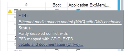

Which brings me in your second screenshot (copy below). That might seem a more immediate solution. Where did you take that screenshot from?
Both my MCUfinder app and the "New Project" Wizard (in CubeMX) don't have that pop-up, nor do they show those columns I can see in your screenshot (Boot, Application, ExtMem). Where is that screenshot from?

There is no table list of acronyms in the reference manual. The acronyms are part of each chapter title as I mentioned above.
I don't know for MCU finder, but the screendshot I've taken is from CubeMX.
