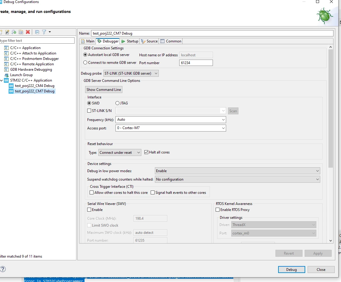

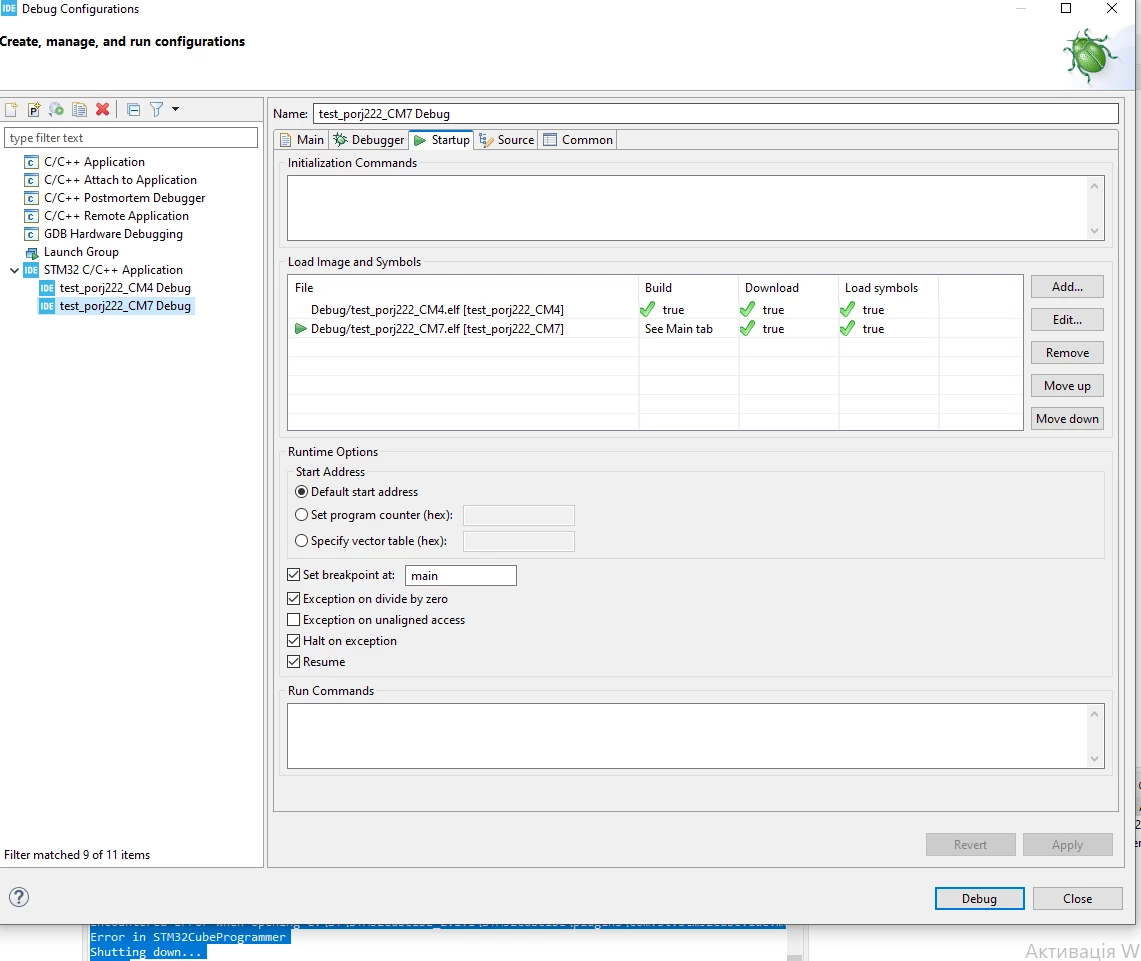

Hi, I’m beginner in this and where’s no a lot of manuals how to do that ,
but looks like I’m done everything but still experience some ”hangs” like after run every debug or run I can’t to anything it’s halt and that’s all
Would be if somebody will help me with that because it’s makes me crazy , THANKS A LOT to this strange which is spent his/her time to help me)
here’s my mcu
https://www.aliexpress.com/item/1005010547748358.html

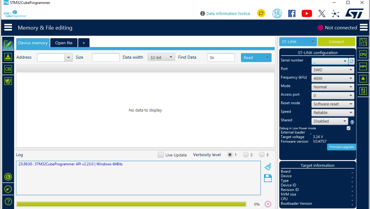

here’s the log what I get when I try to debug nor run , and I tried different ways to launch it but still I experience “halts” of mcu and strange issues with stm32 programmer (looks like it doesn’t see the mcu screenshot below )

Error: Unable to get core ID
Error: No STM32 target found! If your product embeds Debug Authentication, please perform a discovery using Debug Authentication

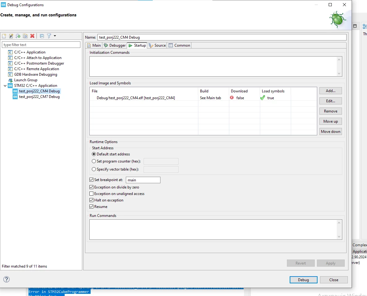

If I tried to debug only one core m7 mcu just halt
STMicroelectronics ST-LINK GDB server. Version 7.13.0

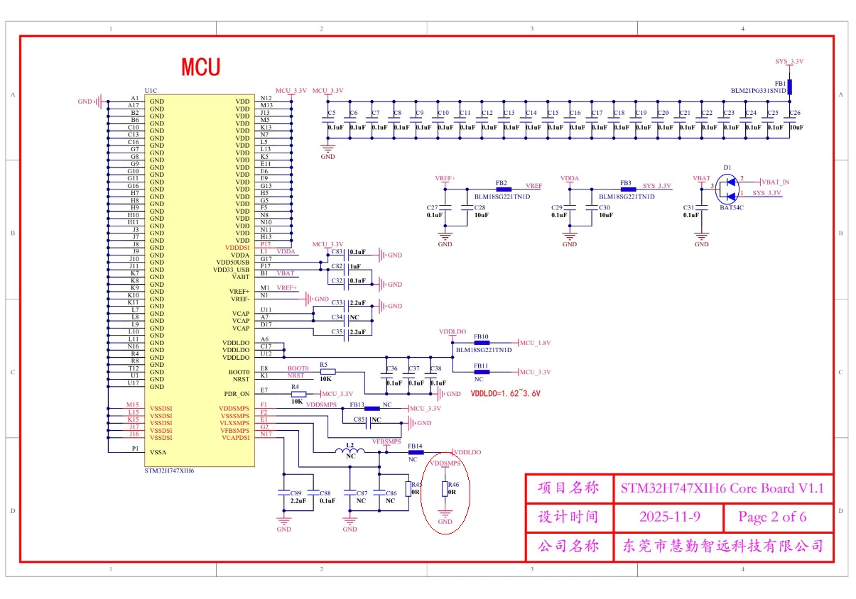

Your post is a little bit hard to follow, because the log and screenshots are posted without much description, so I’m not completely sure if I understood your problem correctly.

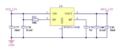

I found a schematic for your board here:
https://www.eevblog.com/forum/chat/stm32h757xih6-board-looking-for-schematic/

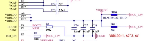

The board is wired for LDO supply only. VDDSMPS (pin F1) is tied to GND through R46 (0R).
None of the components required for the SMPS supply are connected. VDDLDO is powered from a separate 1.8V regulator (RT9013-18GB, U9 on the schematic).
MCU_1.8V supply
VDDLDO supply

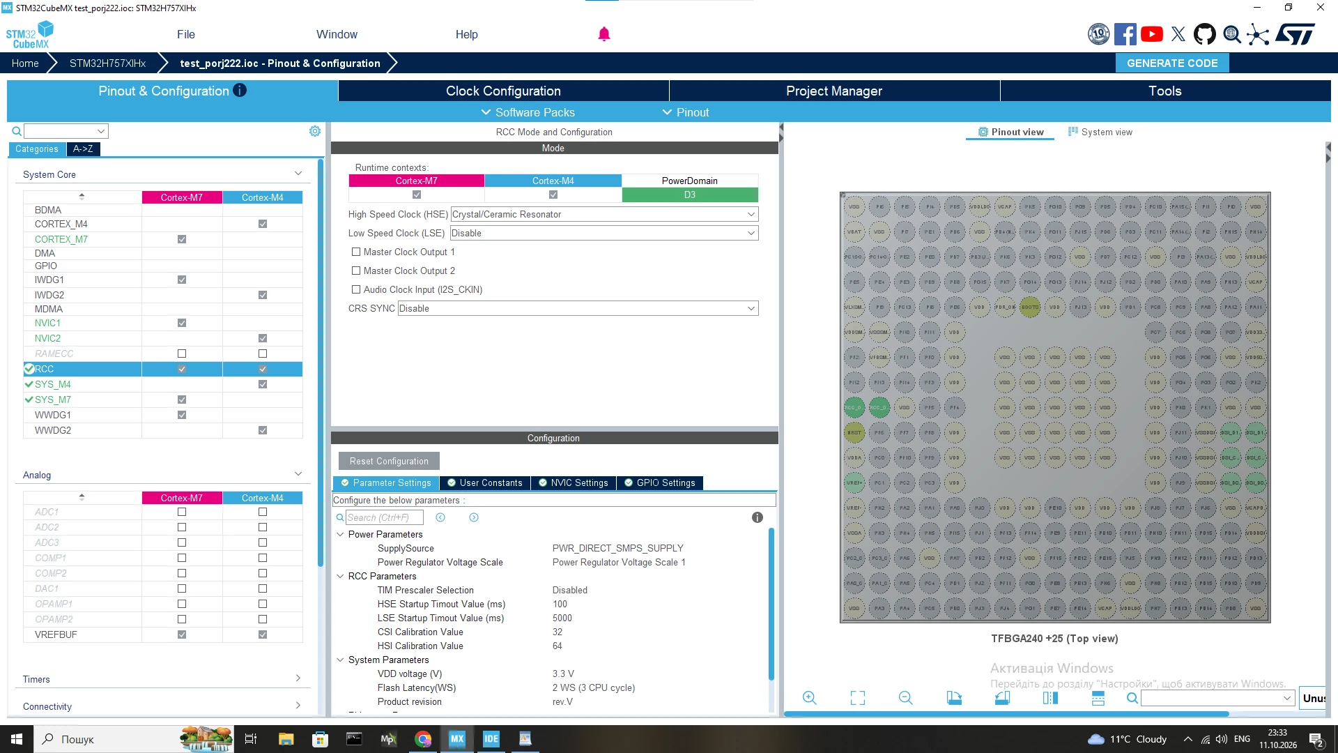

Your CubeMX project has SupplySource set to PWR_DIRECT_SMPS_SUPPLY. That setting switches the internal LDO off and expects the SMPS to power the core, but on this board the SMPS isn’t connected. As soon as HAL_PWREx_ConfigSupply() runs, the core loses its supply and the debugger loses the target. This matches the “Target is not responding” log after download completes.
In CubeMX, set SupplySource to PWR_LDO_SUPPLY. You may need to boot with BOOT0 high to reflash the board. A jumper wire from P2 pin 1 (SYS_3.3V) to P1 pin 8 (BOOT0) should be enough.

​@Lubor Thank you a lot 🫶 Really)
Main lesson here for here not to trust default cube ide settings and don’t work aliexpress boards without their schematics ))
