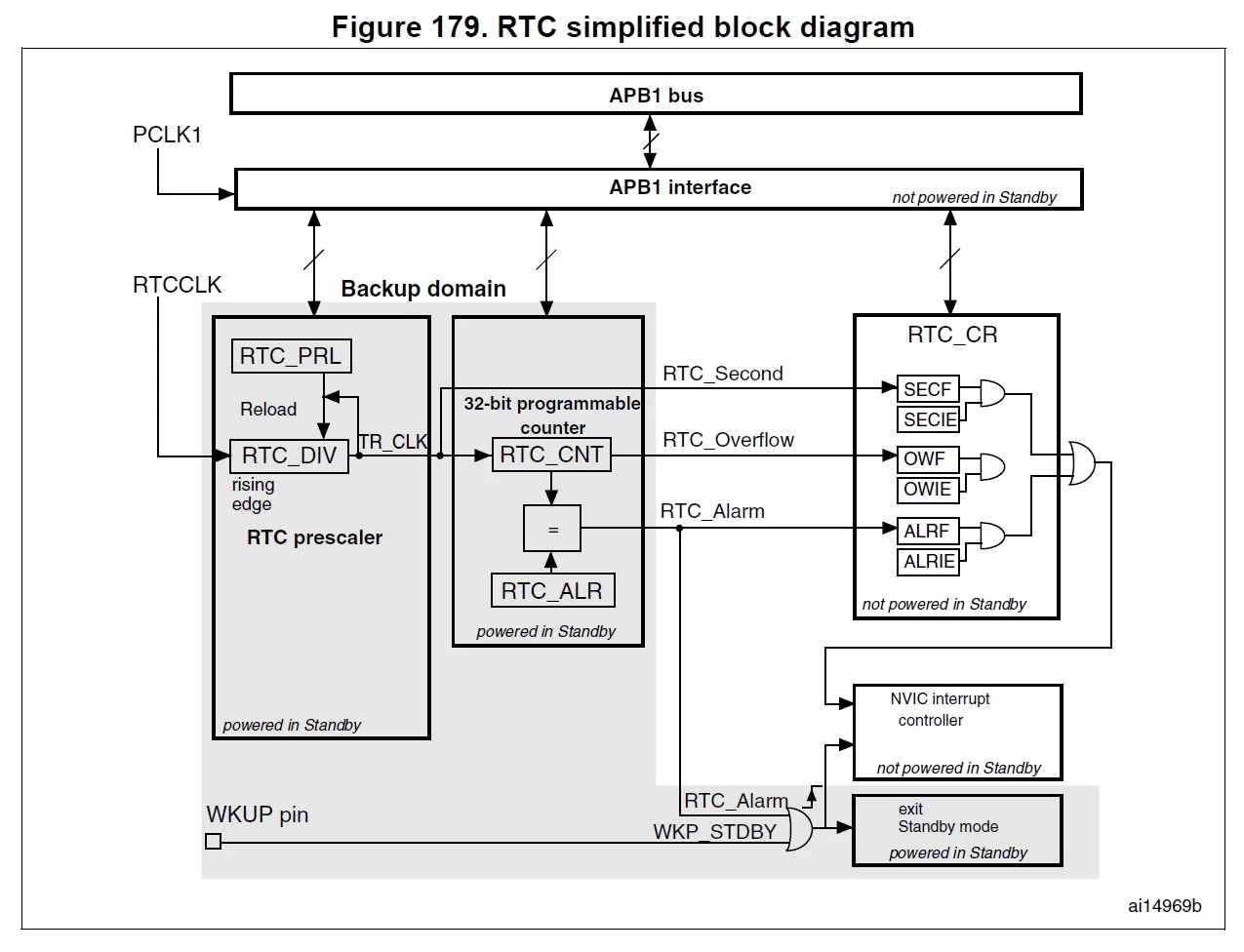

exit STANDBY every second from RTC on STM32F100RBT
  • November 17, 2019
  • 1 reply
  • 986 views
I'm using STM32F100RBT. How can I use HAL_RTCEx_SetSecond_IT to exit STANDBY mode?
I'm able to exit STANDBY using ALARM, and able to get an interrupt every second using HAL_RTCEx_SetSecond_IT , but I can't wake up from standby with it.
What should I do?
Is there an example project?
Thanks!

Not really wired to work that way, perhaps you should just SLEEP for short duration stuff?
