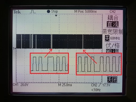

Now the problem has been almost almost solved. There used to be near 900ms of vacant of pulses, and Now the pulses are almost continuous. The stepper motor runs well with this waveform.
Following Clive's advices I adapted my code, then it WORKED!
but the waveform is near ideality
. There are glitches in the waveform and Here is my Explanation:
For normal cases, the CC1IF bit is set and then the TIM1_CC_Interrupt Pending bit(NVIC_SETPEND0.27) is also set by hardware, then
 the hardware could toggle the pin of TIM1_CH1 ,generating the desired waveform.
BUT, there is another situation:
suppose the ISR entered and it was triggered by CC2IF. in the ISR, first I would read TIM1_SR to memory: TIM1_SR_mask = TIM1->SR;
But JUST after I read TIM1_SR, the CC1IF occurs. Because CC2IF bit is high now, the Interrupt Pending bit(NVIC_SETPEND0.27)
will not be set
, so the hardware won't toggle TIM1_CH1 output pin. So we observed a missing of pulse, i.e. two successive low/high voltage levels.
Are my guesses right?
By the way, I think this is not a good design of the chip that if the CC2IF is 1 and configured as a TIM1_CC_IRQ source, then a new arrival of CC1IF(also enabled as a interrupt source) would not pend the Interrupt Pending bit again.
This compels me to add a judgement whether I missed a CC1IF or CC2IF and then manually pend the Interrupt Pending bit.
And this is why I use ''if'' statements and
NVIC_SetPendingIRQ(TIM1_CC_IRQn) before I quit the ISR. This is also a cost of the valuable time of the ISR.
Below is the waveform quite near to ideality. Glitches could still be observed.
Below is my adapted codes:

---------------Split Line. Below is my question. Above is my progress solving the problem--------------
I have corrected/adjusted the content to make this question more clear.
My occasion is: using CCR1 and CCR2 in output compare mode(toggle). Every time in their ISR I add a Delte_CCR1(562) and Delta_CCR2(18000) to generate two different frequencies. I configure BOTH CC1IF and CC2IF as the interrupt source. To make the problem clear, I clear CC2IF as soon as TIM1_CC_ISR enters. Then I Only check CC1IF, if it is 1,I add Delte_CCR1(562) to CCR1. Even if while I am reading CC1IF, the hardware set it to 1, that does not matter because the Interrupt Pending bit(NVIC_SETPEND.27) will be set and next time the TIM1_CC_ISR would handle it.
BUT, the PROBLEM came HERE:
In simulation, there is nothing wrong, the running is exactly as what I expected and then a perfect wave is generated.
But, when I connect to the hardware(with JLink), the wave is corrupted and there would be a 900ms vacant of pulses (which is pure high voltage level) every several seconds...Arrrrgggghhhh....
I add several lines and a breakpoint to test this situation would be happening:
if there are 4 contiuous TIM1_CC_ISR with the CCR1 value unchange, it shows that the problem has happened.

YES, In simulation ,the __nop() breakpoint would never arrive.
But in real-running with hardware, the __nop() breakpoint would arrive every several seconds.

    It should be plainly evident that using RMW on TIMx->SR introduces race conditions because the processor can't access it in an atomic fashion.
    Both RMW and bit-band access can be shown to induce failure.
    The use of a singular write edge to mask current content resolves this, remember the peripheral register are not and do not behave like regular memory cells, and often have combination logic tied around them.
    helixwmonkey
    April 11, 2014
    Posted on April 11, 2014 at 17:39
    Sorry but what does ''singular write edge to mask current content'' mean? Can you offer more details, thanks a lot.
    Tesla DeLorean
    Guru
    April 11, 2014
    Posted on April 11, 2014 at 18:08
    You understand how synchronous logic works, right?
    D := Q & M At the rising edge of the clock the value of Q AND'd with M is latched into D If the SR has 16 bits, Q[0..15] is the current content, D[0..15] will be the new/next value, and M[0..15] is a mask being applied, where the mask bit is ONE the old data passes, where it is ZERO the data is cleared Thus TIMx->SR = M looks like : D[0..15] := Q[0..15] & M[0..15] With the new interupts coming in via I[0..15], the logic is more like : D[0..15] := (Q[0..15] & M[0..15]) | I[0..15] With TIMx->SR &= ~CC1IF; In the most simplistic review of reading and writing (ignoring pipelining, write buffers, and other latency) it will take at least 1 APB cycle between the operations, the TIMCLK is nominally TWICE that.
    CC1IF asserts
    Cycle +0.0 You READ TIMx->SR with CC1IF asserted (X = CC1IF)
    Cycle +0.5 CC2IF asserts
    Cycle +1.0 You WRITE TIMx->SR with (X & ~CC1IF) ie ZERO, this clears CC1IF and CC2IF
    You have now totally missed the CC2IF event.

    Is there any way to Atomically Read & Write this TIM1_SR Register?
    No, not in the way you're trying to doing it.
    You should read the register, service and clear the SPECIFIC source you are servicing. You can then read the register again, and observe if anything else has asserted, or remains asserted. Bits asserted will remain so until you clear them. The act of clearing them is Atomic, in the sense that at the instant you clear it, another pending interrupt will latch in it's place. The only occasion it's going to miss interrupts is when you do the RMW (&=) stuff, or the equivalent via bit-banding.
    wr0 means write-as-zero, writing one bits as no effect.
